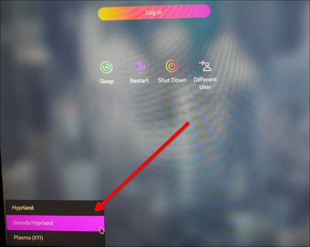

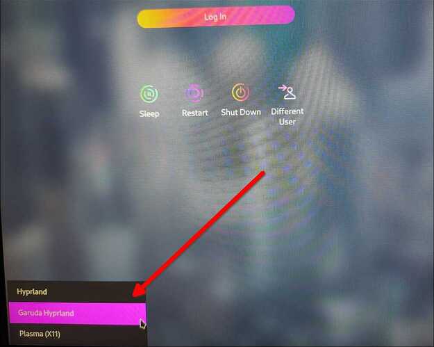

Are you logging in with the “Garuda Hyprland” profile on SDDM?
Yeah confirmed I am logged into Garuda Hyprland.
