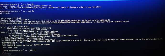

From the Computer doesn’t boot, boots to a black screen, or stops at a message tutorial, I tried doing this:
sudo reflector -a6 -f5 --save /etc/pacman.d/mirrorlist
garuda-update
and
startx
Both didn’t work, errors attached below. I was able to update the system, though.

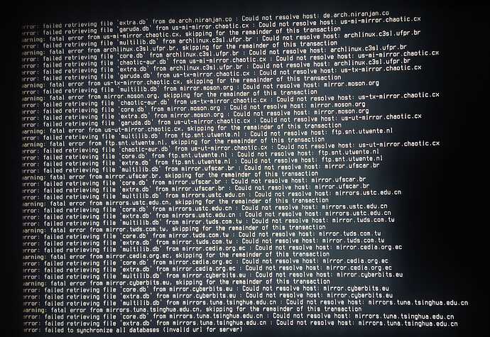

Moving down to
sudo dkms autoinstall
I got another error, but by adding --force to the end, I was able to update and replace everything. However, apart from that, there was no other output.

The mirror list failed is, you have no internet connection.
I’m stuck there. I used systemctl reboot --firmware-setup to go into BIOS and change my boot priority order, but I still can’t see anything. ^^;
As for the Internet, I thought I would have been connected already since I was connected to my Wi-Fi prior to the screen going black. I tried reading the arch wiki on how to connect via WiFi, but I wanted to be sure there wasn’t a simpler way to reconnect.
