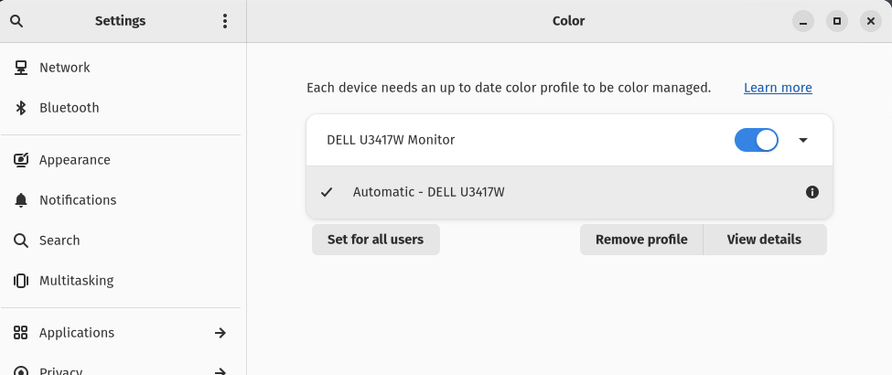

Launch GNOME's settings app and adjust colors from there. Also DKMS drivers ie. nvidia-dkms are compatible with different kernels.

I’m not allowed to change colors in the settings.
