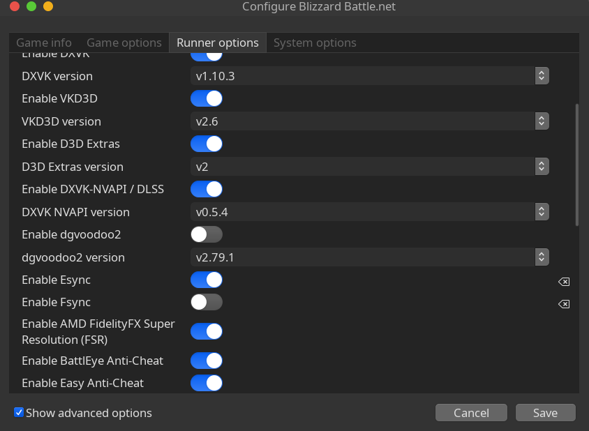

How did you install WoW Dragonflight? Did you install DXVK / VKD3D? If you start game with MangoHUD do you see maxed out RAM or VRAM?
Maybe you can pick up something useful here:
How do you installed the Battle.net client? Through lutris? If yes, just disable Fsync in Configure -> Runner Options.
