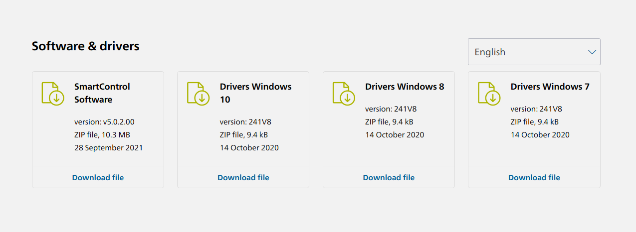

Can you examine the monitor and try to determine what the model number is?
It's Philips 241v8la/00, but as I said, I don't think it's hardware fault, I have Windows 10 on other partition and it works well.

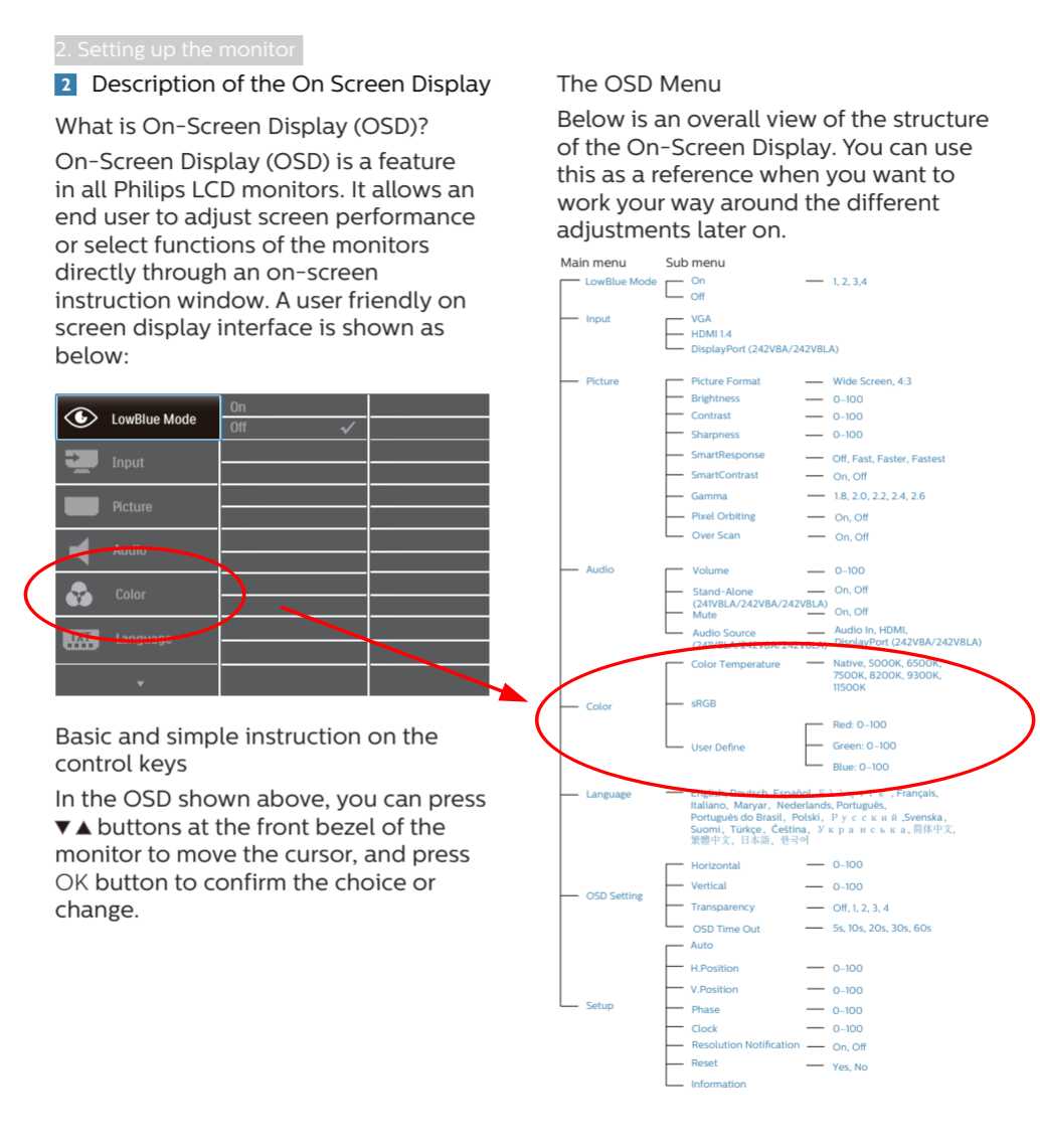

There should be a color menu accessible on your monitor where you can manipulate the color bias you are seeing and try to achieve a more reasonable balance.
That may be true, but keep in mind the manufacturer made a special driver for this device that is only available for Windows.
Even if you did not intentionally download this driver, it is very likely your machine was able to download it (or a version of it) without your knowledge or with an unobtrusive notification while you were setting up the monitor.
It is impossible to say exactly what that driver does, but it is certainly possible that it automatically adjusts the color of your monitor for you, or other things that you will have to do manually without the special driver.

what is the connection ? hdmi, usb-c etc. going via a dock etc
