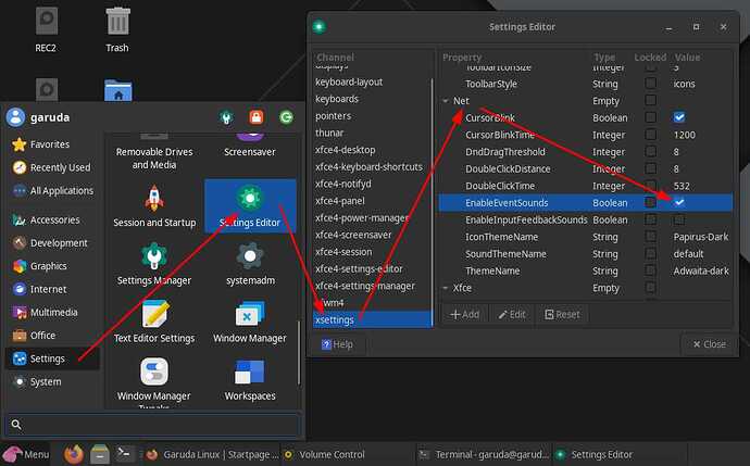

There is another place in the GUI where sound events are enabled by default. I'm not sure if this will be a fix or not, but it's worth a shot.
Settings -> Settings Editor -> xsettings, in the Net submenu there is a setting called EnableEventSounds which can be unticked.
Sadly, that was also disabled. looks like that matches the main setting i found in settings manager as it switchs if i select that setting.
