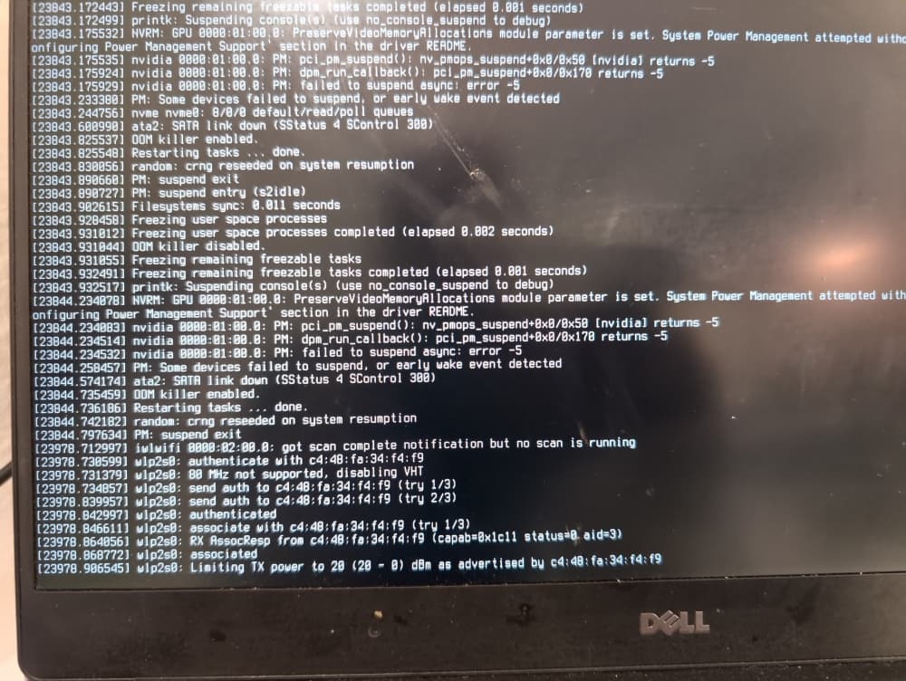

Lately when I have left my laptop unattended to for 5 minutes or so I come back to find the following screen:
What is happening?

sound like a nvidia driver problem again.Many people have Problems when the Laptop goes for sleep or turn off Display.
i read in a other Forum they solved some issues if they uninstall the nvidia driver an install the 353 version with blacklisted nouveau driver.
or you turn off the settings for hibernate or display off after 5 minutes.(only my thinking the newer laptops dont use much power like older laptops so if i know i dont come back after 15 minutes i shut it down and start when i need it.Startup time same as waiting for reactivation from sleep)
I dont have a Nvidia Card anymore so i cant test it or have trouble with nvidia cards to solve. im more an AMD Fan =)
I was having problems with nvidia and ended up having to reinstall Garuda with open source drivers only. Hopefully it doesn’t come to that with your set up
Yes, so it must be an nvidia issue.
I cannot seem to uninstall anything though!

SOLVED!
I used Octopi to re-install dkms-nvidia.
