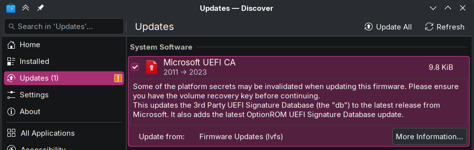

Strange Microsoft UEFI CA firmware update message
That’s a strange message about invalidating hardware secrets. Should I be installing this? I’m guessing it’s updated firmware signatures for UEFI. It’s not likely to break anything right?

I’m no expert, but this seems to be legitimate. Try running fwupdmgr update in terminal. It usually provides more details.
do NOT use discover for updates. please use the official update program garuda-update which can be called from the terminal via garuda-update OR update OR upd
This is generally good advice, that said, garuda-update doesn’t handle flatpak updates which Discover does, and I don’t think garuda-update handles fwupdmgr updates either. I think Discover is safe for flatpak updates (or you can run it via terminal too, I guess, via flatpak update). I’ve never had a successful update execute for FW updates via discover, and can only run it via terminal (i.e., fwupdmgr update).
Install and use Topgrade. First run Garuda-Update then Topgrade. Discover is only really good for Plasma addons and theme components.
OO! Never heard of topgrade before! Thanks for the tip :wink:
If you are not familiar with fwupd/fwupdmgr you could install and use gnome-firmware. It´s a GUI tool for updating firmware supported by fwupd.
Topgrade will update that as well.
According to the Arch wiki, Discover is just another front end to fwupd. If gnome-firmware is safe for firmware updates, Discover is probably fine too (not for general Arch repo software installs or updates, though).
So in the end I tried Topgrade per Locutus’ suggestion. Handy looking tool, doing the 3 kinds of update: general repos, AUR with paru, and firmware. Topgrade seemed to do the update, so I rebooted. After that Discover thought the update still needed doing so I attempted it but got an error:
ERROR
Failed to download metadata for lvfs: network is unreachable: Host unreachable.
However, Topgrade reports
Devices with the latest available firmware version:
• UEFI CA
• UEFI dbx
Devices that have been updated successfully:
• UEFI CA (2011 → 2023)
So that looks good. Fingers crossed all is well.
