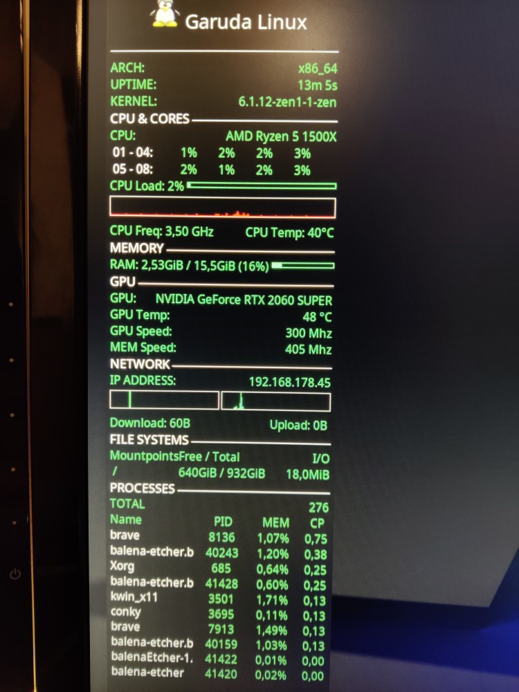

It just happened again, I just had brave open and balena-etcher to flash a usb drive.
This is the last picture of conky before the freeze
I think it's a hardware problem, I can't find anything relevant in the logs
I think @Kayo point it out. Not a heat problem I thought.
