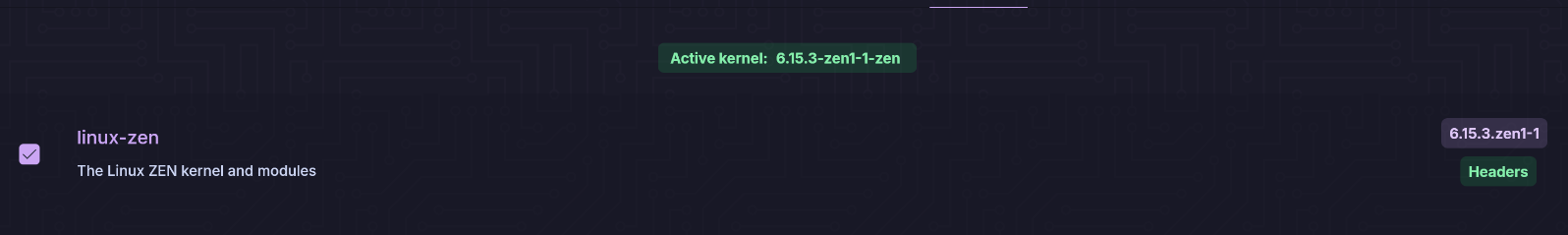

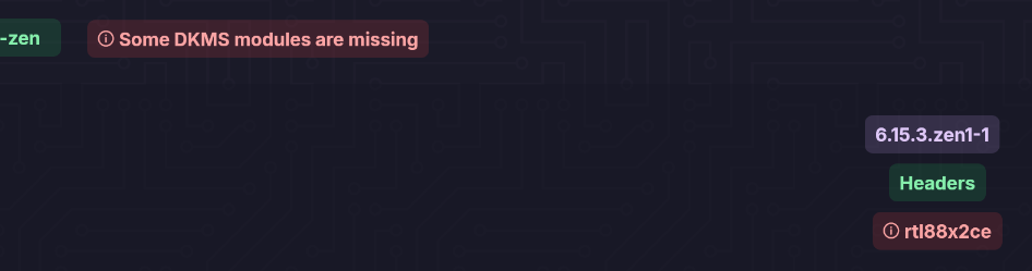

Hi, I try this driver AUR (en) - rtl88x2ce-dkms-git but not work the WiFi. In Gaurda Rani i see this in kernels
But nothing pass if i click de bottom. I believer these error is for kernel but if i try other kernl (cachyOS) not run KDE and WiFI not work.
That’s the correct package to install, unfortunately upstream needs to be updated. I’ve opened an issue where you can check the progress of the fix:

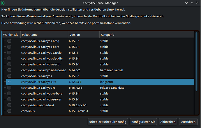

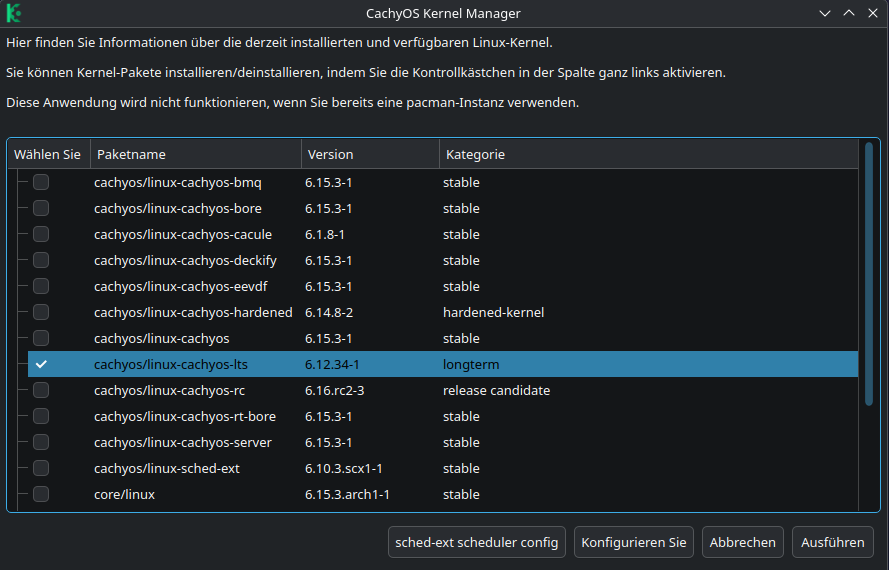

In the meantime, you can get the LTS version of CachyOS kernel, since it’s old enough that it should build the DKMS module correctly. Just choose it at boot time. You can also set it as the default selection in Garuda Boot Options, and change it back from the default when the module has been patched to build for the new kernel, and you have confirmed everything is fine.
sudo pacman -Syu linux-cachyos-lts linux-cachyos-lts-headers
would probably need the linux-cachyos-lts-headers instead, right?
Sure does!
