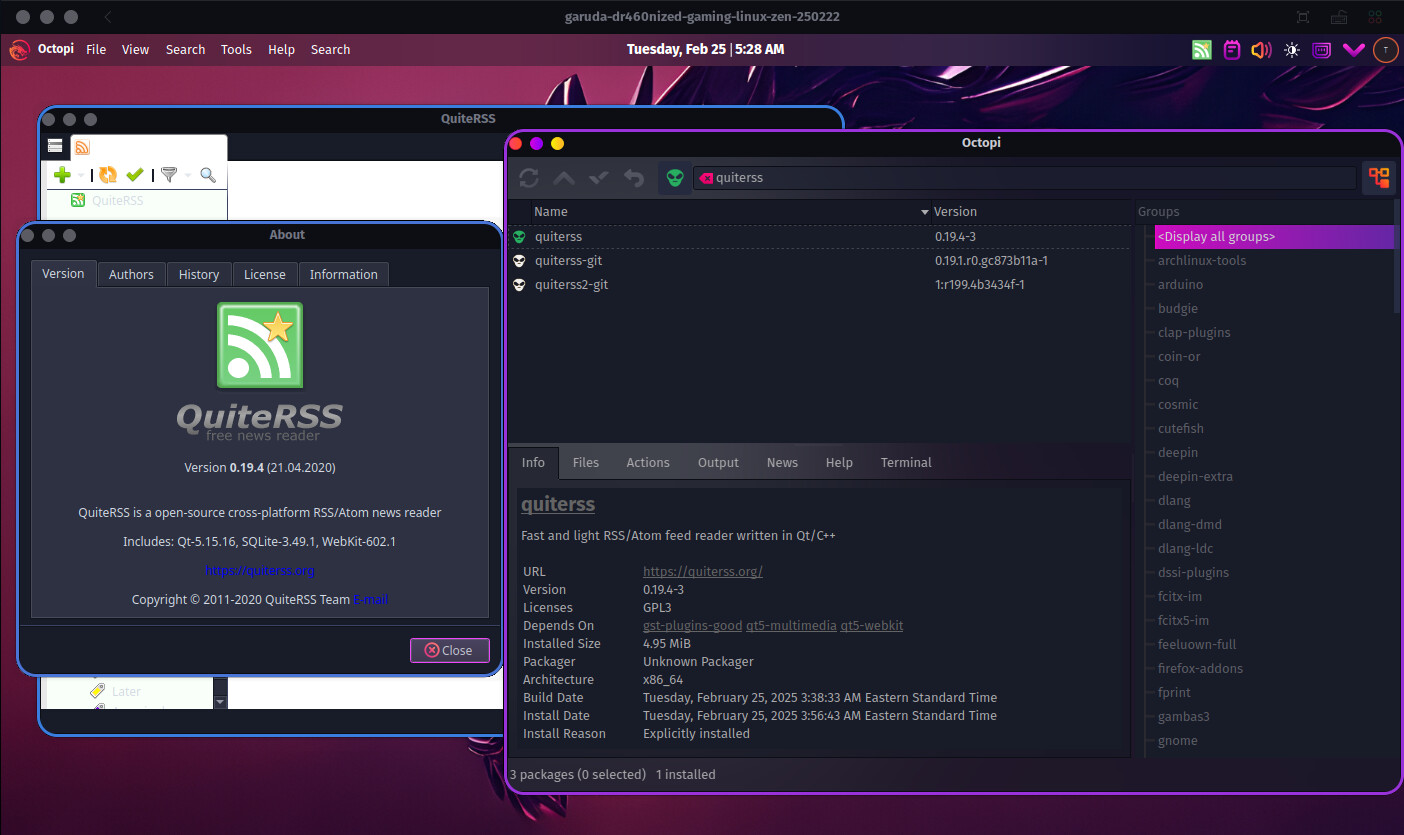

Try installing quiterss via octopi. Tested in a VM without issues:

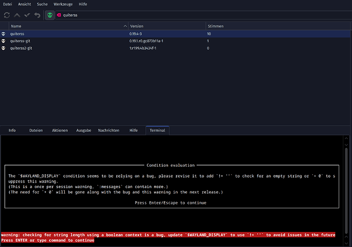

Funny, pacseek failed too
 The `$WAYLAND_DISPLAY` condition seems to be relying on a bug, please revise it to add `!= ''` to check for an empty string or `+ 0` to suppress this warn │
 │ ing.                                                                                                                                                       │
 │ (This is a once per session warning, `:messages` can contain more.)                                                                                        │
 │ (The need for `+ 0` will be gone along with the bug and this warning in the next release.)                                                                 │
 │                                                               Press Enter/Escape to continue
Same on octopi

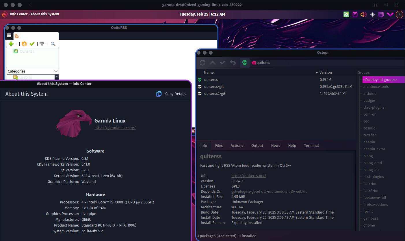

Only X11? :grimacing:
Nope, installed and tested exclusively on wayland:
