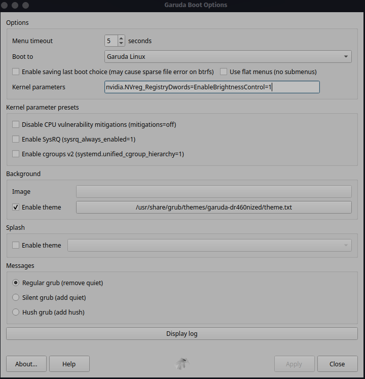

I do not think you should follow that advice. See this warning from the ArchWiki:
NVIDIA - ArchWiki
Warning: Avoid installing the NVIDIA driver through the package provided from the NVIDIA website. Installation through pacman allows upgrading the driver together with the rest of the system.
Have you tried any of these suggestions? https://wiki.archlinux.org/title/NVIDIA#Enabling_brightness_control
Enabling brightness control
Add to kernel parameters:
nvidia.NVreg_RegistryDwords=EnableBrightnessControl=1
Alternatively, add the following under section Device:
Option "RegistryDwords" "EnableBrightnessControl=1"
I believe the “section Device” they are referring to is a specific section in the Xorg configuration file, probably either in /etc/X11/xorg.conf or in a file within the /etc/X11/xorg.conf.d/ directory. You may need to switch to a X11 session if you want to test that suggestion, I’m not sure.
I’m unable to install nvidia-bl-dkms it seems. Not sure why I couldn’t find it in pacman or octopi. But I did have the kernal perimeters set to nvidia.NVreg_RegistryDwords=EnableBrightnessControl=1. I did learn this is my card atleast under that code name thing NV197 (AD107) GeForce RTX 4060 .
It is in the AUR.
❯ paru -Ss nvidia-bl-dkms
aur/nvidia-bl-dkms 18.11.0-2 [+4 ~0.00] [Out-of-date: 2020-07-26] [Orphaned]
    Driver to adjust display backlight on legacy mobile NVidia graphics adapters - DKMS edition.
But I would not install that package if I were you, it has been flagged out of date for many years. Even in the wiki it says that suggestion is out of date.
How do you have it set? It is not showing up in your kernel parameters in the inxi output.
that’s weird, I stuck it in the Garuda boot area
The situation seems to have worked itself out and I have no idea how or why. I updated on hybrid when it was at 100% brightness and after I did an update I switched back to discreet but then after booting to the desktop everything locked up and my screen froze. Switching boot options didn’t help and my snaps would have put me all the way back to the 5th of January so then I thought, lemme switch back to hybrid and see what happens. Then boom I switch back to hybrid, have brightness control, battery save mode on, and everything the way I need it !! Thanks again for your patience :slight_smile:
edits: now my HDMI port doesn’t work which sucks because instead of being able to take the sound from the other source I have to turn my sound way up to max which is not nearly loud enough in a large room with such tiny sound. I do know there’s a setting called UWA or something between hybrid and discreet and that one disables your HDMI but I never used that one and am currently on hybrid right now
