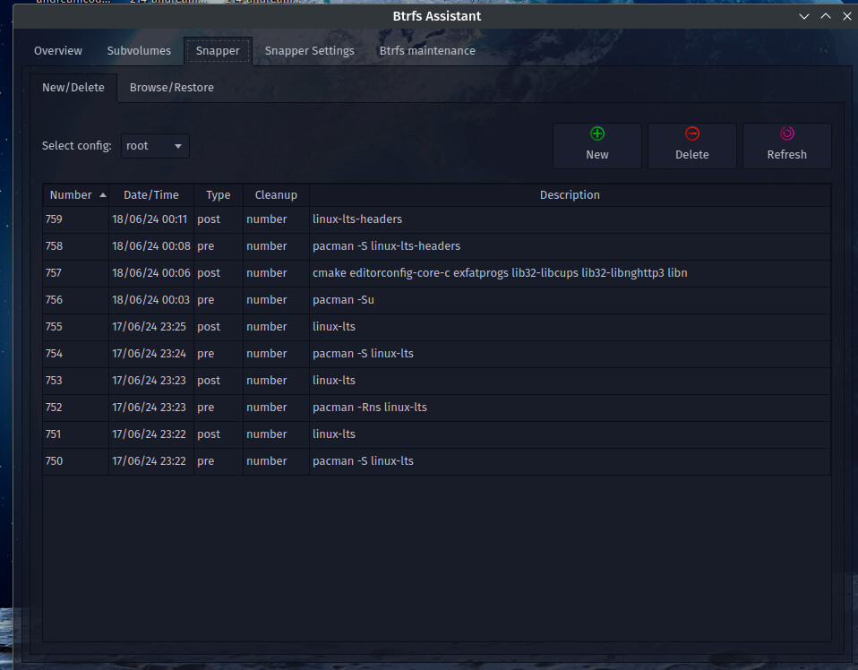

as for the snapshots, I attach the photo for clarity, now the last one dates back to yesterday evening

Then you can forget my suggestion with an old snapshot.

Found snapshot: 2024-06-18 17:18:39 | @/.snapshots/760/snapshot | pre  | pacman -S a52dec aalib abseil-cpp accounts-qml-module accountsservice ac |
Found snapshot: 2024-06-18 00:11:39 | @/.snapshots/759/snapshot | post | linux-lts-headers                                                        |
Found snapshot: 2024-06-18 00:08:56 | @/.snapshots/758/snapshot | pre  | pacman -S linux-lts-headers                                              |
Found snapshot: 2024-06-18 00:06:48 | @/.snapshots/757/snapshot | post | cmake editorconfig-core-c exfatprogs lib32-libcups lib32-libnghttp3 libn |
Found snapshot: 2024-06-18 00:03:35 | @/.snapshots/756/snapshot | pre  | pacman -Su                                                               |
Found snapshot: 2024-06-17 23:25:10 | @/.snapshots/755/snapshot | post | linux-lts                                                                |
Found snapshot: 2024-06-17 23:24:44 | @/.snapshots/754/snapshot | pre  | pacman -S linux-lts                                                      |
Found snapshot: 2024-06-17 23:23:35 | @/.snapshots/753/snapshot | post | linux-lts                                                                |
Found snapshot: 2024-06-17 23:23:30 | @/.snapshots/752/snapshot | pre  | pacman -Rns linux-lts                                                    |
Found snapshot: 2024-06-17 23:22:42 | @/.snapshots/751/snapshot | post | linux-lts                                                                |
Found snapshot: 2024-06-17 23:22:15 | @/.snapshots/750/snapshot | pre  | pacman -S linux-lts                                                      |
Found 11 snapshot(s)

Is the error message still there?
envycontrol removes the card from the PCI bus by using udev-rules when switching to the iGPU. The question is why envycontrol could no longer change the udev-rules and why this also did not work during the uninstallation of envycontrol (this undoes all changes) :thinking:
Any udev experts present?
yes, the error message is still present
I’m waiting to see if anyone is experienced with udev, otherwise I’ll proceed with removing the drivers
We hope that someone succeeds, especially if in the future there will be someone with the same problem who cannot do without the nvidia card
Then remove the nvidia drivers, then the error message should disappear. You don’t need the drivers at the moment anyway because the nvidia GPU is deactivated.
Post the output of
ls /etc/udev/rules.d/
and
ls /lib/udev/rules.d/
