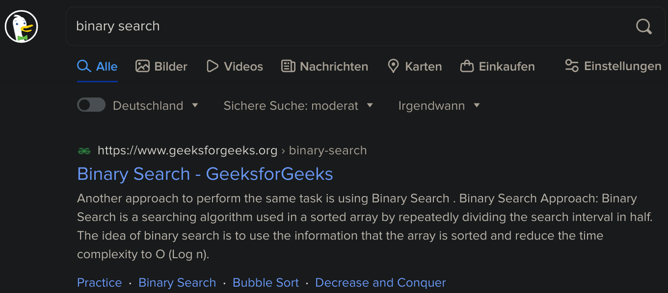

Learn to search.
How does it work with yahoo search?

“Binary search” is the name for splitting things into two halves and looking at each half in turn, then rejecting half of the things and splitting in half the remaining things.
If there’s one thing you’re looking for then binary search is a very efficient way of finding it. If there’s more than one thing then you have to start a “new” search for both halves when both halves meet the test.
If you search online you should be able to find some bash scripts to automaticaly check the file names for you. I have used ones I found online in the past.
