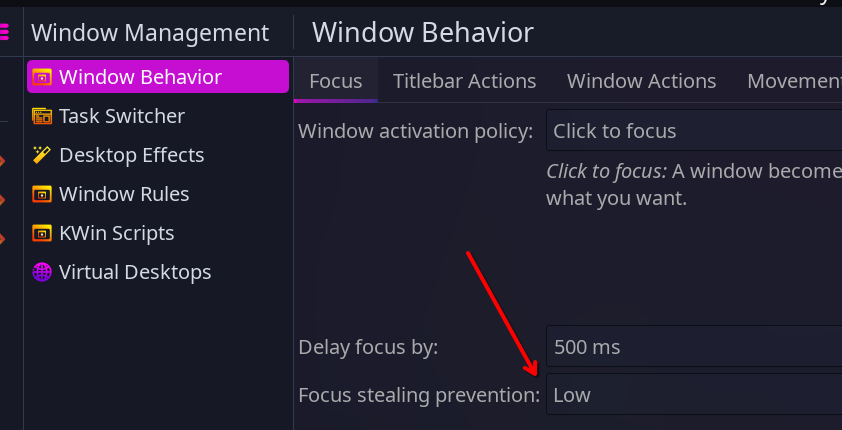

I think there is a setting in System Settings to always bring Administrative Windows up to focus on foreground.
EDIT: Try with this:
I just checked, and it has been like that all this time.
Try Medium or higher setting and see if it makes sense for day to day use.

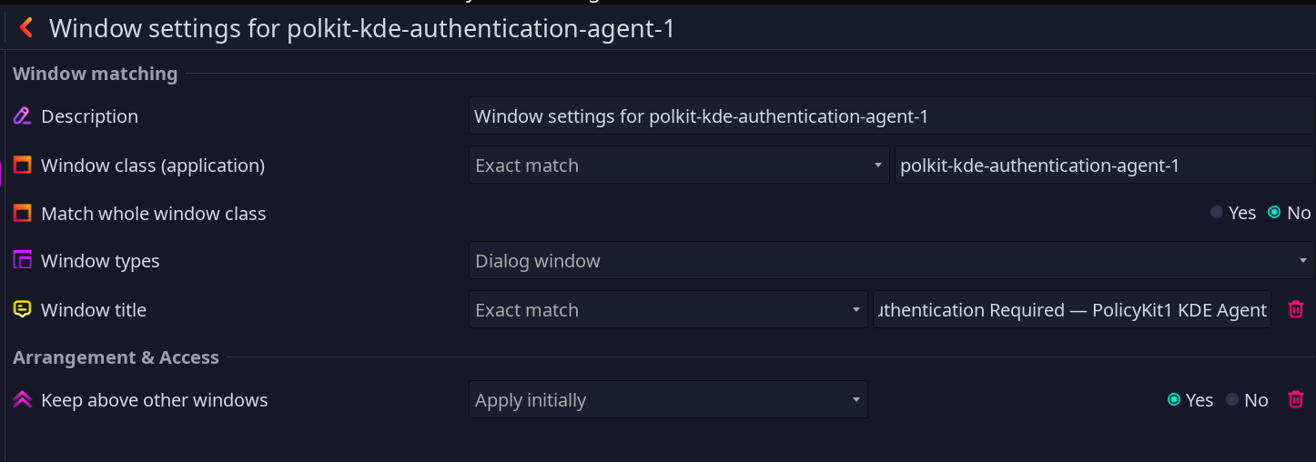

Last resort, which now I remember is what I did, you can create a Window Rule:
Don’t copy what I have exactly, bring the window in focus, create a new rule and click the Detect Window Properties in System Settings to add properties for the window and test and retest until it works as you wish.

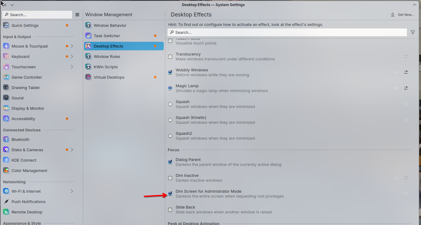

This setting here also make it a bit more clear to see it wont help it be on top but make it noticeable
Thanks elite,
It works as it should be now.
