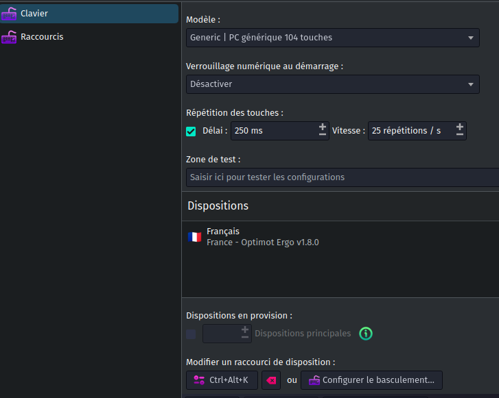

When I installed my Garuda, since I’m French, I used the bépo keyboard layout. I now to switch to the more optimised optimot, which I installed without a itch on my session. It is the only layout on my system.
My problem is that the login screen has not updated to this layout, it is still in bépo, even if bépo is not installed on my computer anymore.
Here is my keyboard setting:
And when I try Ctrl+Alt+K it show me only the optimot layout.

Is there a place where the systems settings about the keyboard (my first screenshot) are stored? I could look the name there and use the same for the ssdm.
~/.config/kxkbrc

So, this place ~/.config/kxkbrc told me the name of the layout but SDDM is in US Qwerty with it. I suppose it is not possible to use custom layout outside of the one installed on the system.
Thank you all for your reply, I will search in another way.
