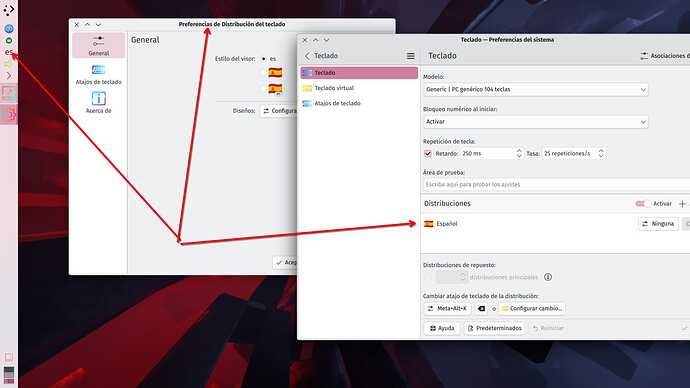

hello ksso,
please reboot your system and take a picture of the same picture youre already did.
Thank you very much

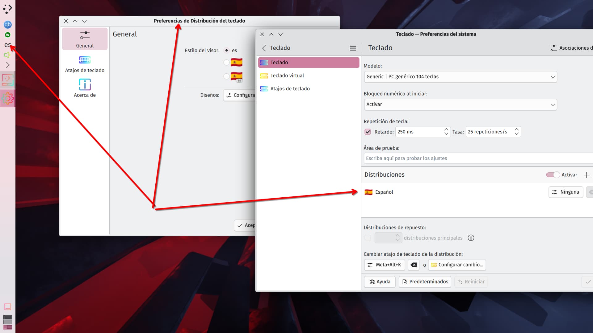

please Add your latinoamerican spanish to it.
Dont delete Spanish.
After you added your latinoamerican spanisch please press APPLY.
Then you see left beside the layout names 3 Stripes like a menu symbol.
Move your latinoamercan spanisch to first Position and APPLY again then reboot to see an effect.
It returns to Spanish and Latin-American doesn’t appear
Make sure to order them properly, when Plasma reboots it defaults back to the 1st layout on top.
Yes I do, but Latin-American disappears after reboot.

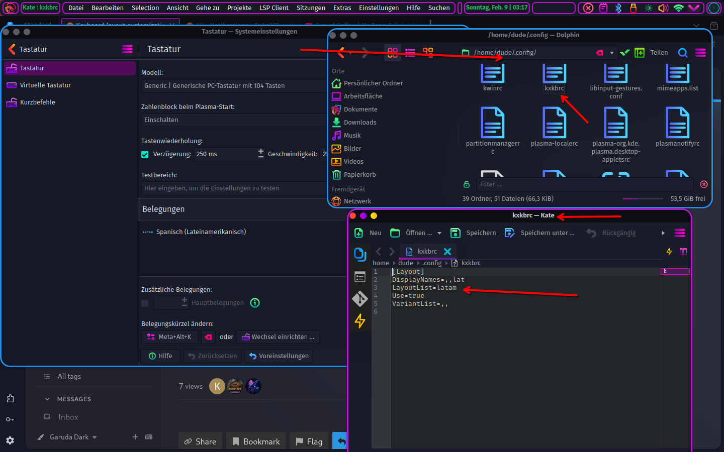

maybe you can try to chance this in those file.it works on my Garuda without issues.
I tried with german,uk and your latino amercano spanish.
take a look to this file and chance the marked to latam and safe it (ctrl+s safe shortcut).
Then reboot.
file with your account name . /home/yourname/.config/ copy paste to dolphin and replace your name.

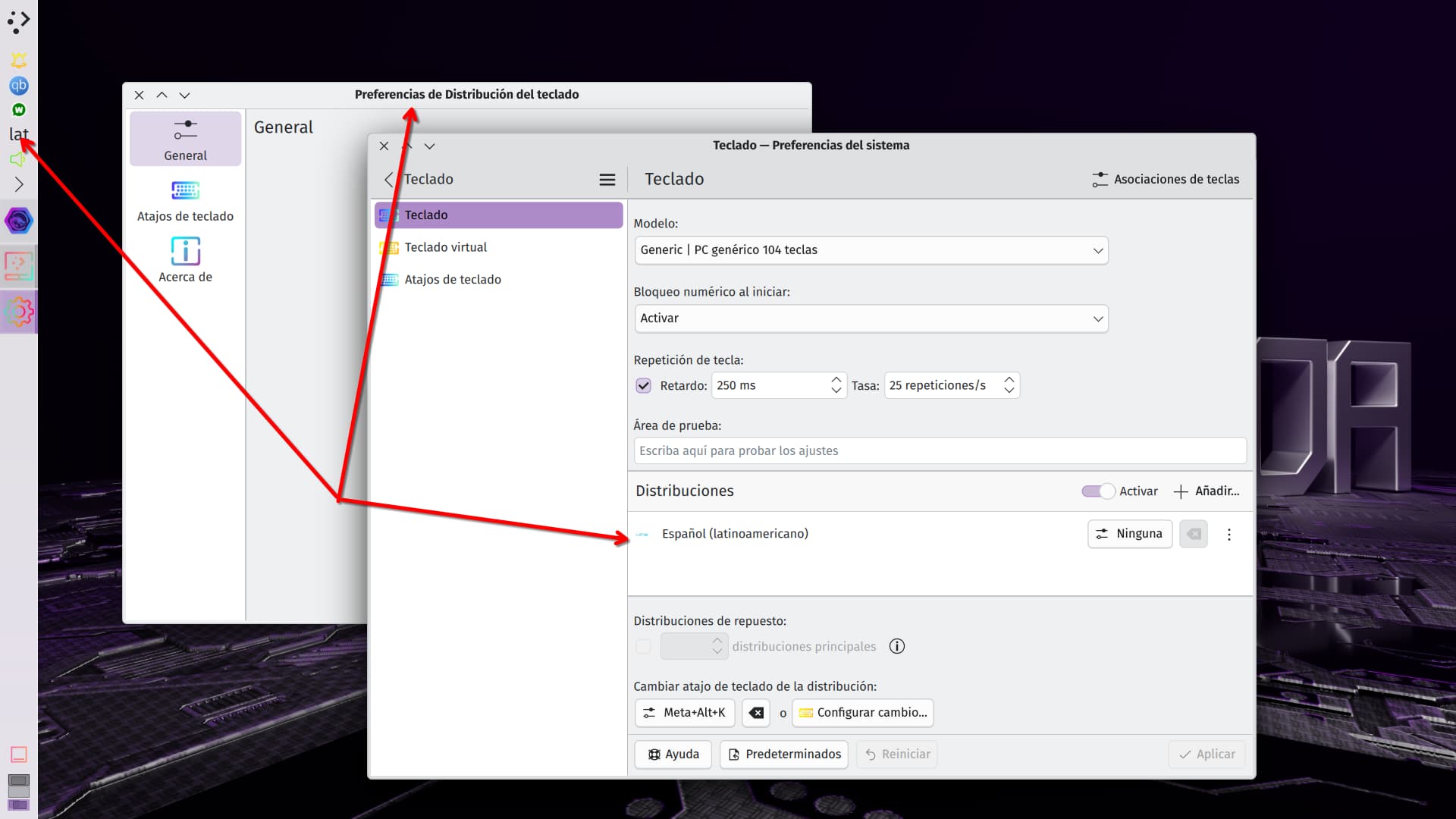

Go to ~/.config/ and delete the kxkbrc file.
Open the KDE-Settings → Keyboard and add the layout “Spanish (Latin American)” again → Apply (at this moment the kxkbrc will be recreated) and close the Settings. Then reboot and check if it works.
If not, post the content of your kxkbrc here.
