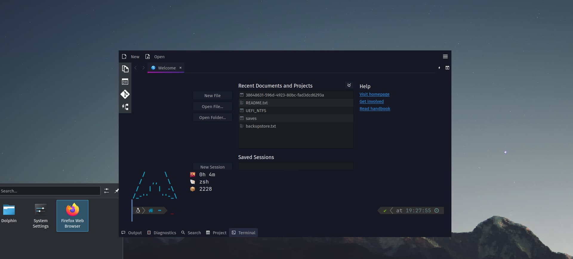

Just upgraded, window decorations are gone, i cant move windows around

nope, the same thing after i reboot
Looking at your inxi… looks like the kwin WM went missing somehow? :face_with_spiral_eyes:
how can i install it back?
pacman -S kwin ?
Would be best to try to find a working snapshot.
After that is done and rebooted, try garuda-update again.
i recovered from snapshot, it was working fine. Then i updated and and it happened again :<
