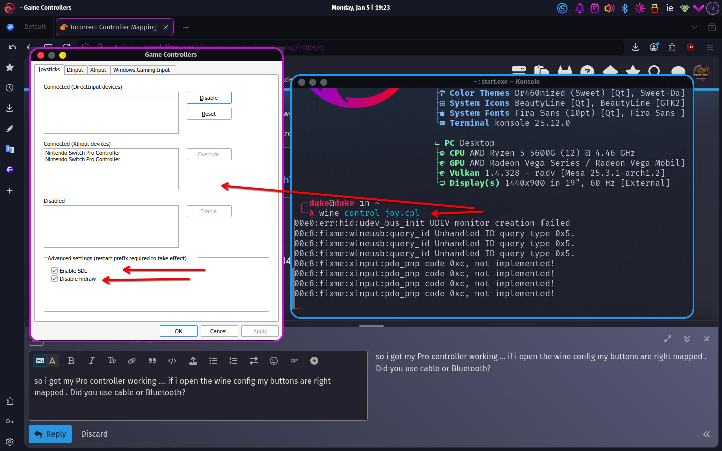

hi,
Did you try maybe AntimicroX ? Is it a N-switch controller? I have a Pro Controller but not testet yet on the Pc because i use my ps4 Controller.
Install over the Terminal : (enter)
There you can remapped them and save the Profile.
I also use Lutris for my games to set it up in there Settings .
sudo pacman -S antimicrox

hi,
it is a Kernel module but if its not loaded you can load it manually like this here:
check if its loaded
lsmod | grep hid_nintendo
if its show a error load it.
sudo modprobe hid_nintendo
check it again.
Did you checked this website?
My Nintendo Pro Controller didnt work i try to figure out why so i cant test future stuff actually.
so i got my Pro controller working … if i open the wine config my buttons are right mapped . Did you use cable or Bluetooth?

if it not changed via the modprobe it could be an issue of wrong detects .
In wine settings gamepad those hooks use then SDL instead of hidraw.
Maybe you have to set a udev rule for the controllers on your own. I did it because my Pro Controller didnt worked but with the udev rules i set it was working. Thats the bad thing with cloned controllers.
I think I’ll set a udev rule for my controllers. Would you mind explaining how you set udev rules for your controller to me?
I’m not on the pc yet if I’m on it I can share it but you should may get your Mac address from the pro controller.
I did it like this:
  1. Connect your Pro Controller via Bluetooth
  2. Then run this command sudo dmesg | grep -i hid
  3. Look for your information like this here:
8087.877603] nintendo 0005:057E:2009.0006: hidraw5: BLUETOOTH HID v80.01 Gamepad [Pro Controller] on 48:51:c5:f7:88:d3
[ 8089.312845] input: Pro Controller as /devices/virtual/misc/uhid/0005:057E:2009.0006/input/input19
[ 8089.312996] input: Pro Controller (IMU) as /devices/virtual/misc/uhid/0005:057E:2009.0006/input/input20
  1. Look also the output from here:
cat /proc/bus/input/devices
I: Bus=0005 Vendor=057e Product=2009 Version=8001
N: Name="Pro Controller (IMU)"
P: Phys=48:51:c5:f7:88:d3
S: Sysfs=/devices/virtual/misc/uhid/0005:057E:2009.0006/input/input20
U: Uniq=98:B6:21:B4:C5:F4
H: Handlers=event17
B: PROP=40
B: EV=19
B: ABS=3f
B: MSC=20
  1. Now you should have all informations to set up the udev rule. Open the Terminal and create it like you want with your own name. My example: sudo nano /etc/udev/rules.d/99-silvercrest-controller.rules
You have to change the ATTRS idVendor->idProduct->name->adress to your infos !!!
CTRL+O to Safe it CTRL+X to close it. Then do a reboot and see if it work for you.
# Silvercrest Switch Pro Clone - force joystick tag and permissions
SUBSYSTEM=="input", ATTRS{idVendor}=="057e", ATTRS{idProduct}=="2009", ENV{ID_INPUT_JOYSTICK}="1", MODE="0666", TAG+="uaccess"
# Alternative if VID/PID not direct (Bluetooth parent)
SUBSYSTEM=="input", ATTRS{name}=="*Pro Controller*", ENV{ID_INPUT_JOYSTICK}="1", MODE="0666"
# Or by MAC if needed
SUBSYSTEM=="input", ATTRS{address}=="98:B6:21:B4:C5:F4", ENV{ID_INPUT_JOYSTICK}="1", MODE="0666"
Please also check this Site for any help .
