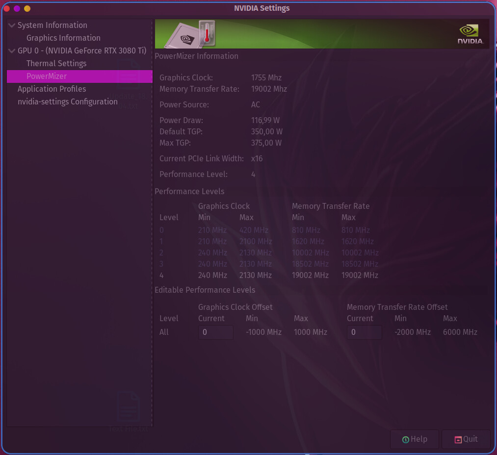

I have no those options you talk about!
Hello Jeshu!! I’m on Wayland and I have no those options you talk about!

I don’t have any issues (that I noted so far) that obstruct or impend my actual use of Garuda and I don’t think I need to open another topic if I found this here reading the Foorum. I’ve followed the Jeshu advise for that guy and that was when I’ve seen I have not those options in my “nvidia-settings” I will put now here, the inxi output and the screenshoot, but if you still want me to open a new topic, I will do that, no problem. Cheers!

ok..you stay on wayland..logout..switch to X11 → login → same procedure.
Open console run sudo nvidia-settings → make your settings and after all click on save.
Reboot pls → login wayland → and ?
But before..make a bios update pls.
