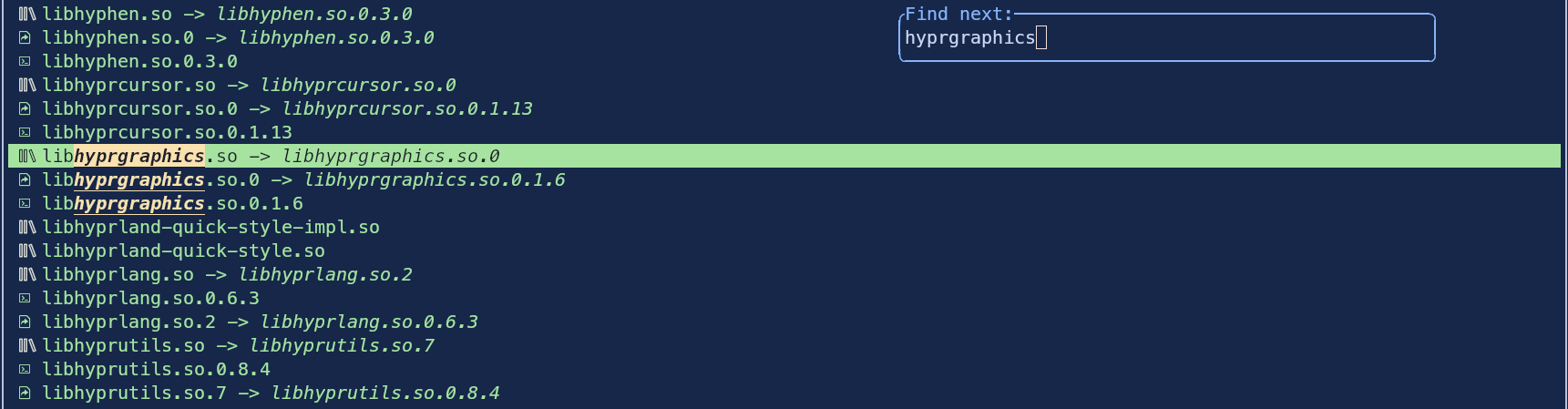

I found this in the git repo, not sure if this is helpful tho:
thanks for the reply. I’ve found this as well, but I don’t know how to fulfill this step. I’ve tried to reinstall the hyprland and the hyprgraphics package with no success
Presumably, what’s available in the repo is already compiled and ready to use. Unfortunately, this closed issue’s “resolution” was to just rebuild it locally. Can you try that, maybe that will fix the issue?
I cloned the package and built it, but it did not change anything, hyprland still does not start
Maybe re-open the closed issue and explain you followed the steps and still getting the same error, and that you’re having the same issue from the downstreamed Arch repo…
Can you rollback at least your system through snapshots , untill it will get resolved , IG it is some symlink issue … :eyes:
To add to this, after rolling back, I would exclude that package from updates until it gets resolved.
I tried the oldest image i have, but sadly it was also from yesterday evening and did not work. As everything worked flawlessly for such a long time, i did not create a image for fallbacks..
I will reopen the issue on github. If its about the latest update, i guess more people will have the problem.
I’ve got an answer from someone withe the same problem. His solution was to switch from hyprutils-git to hyprutils. This solved also my problem. Thanks a lot.
