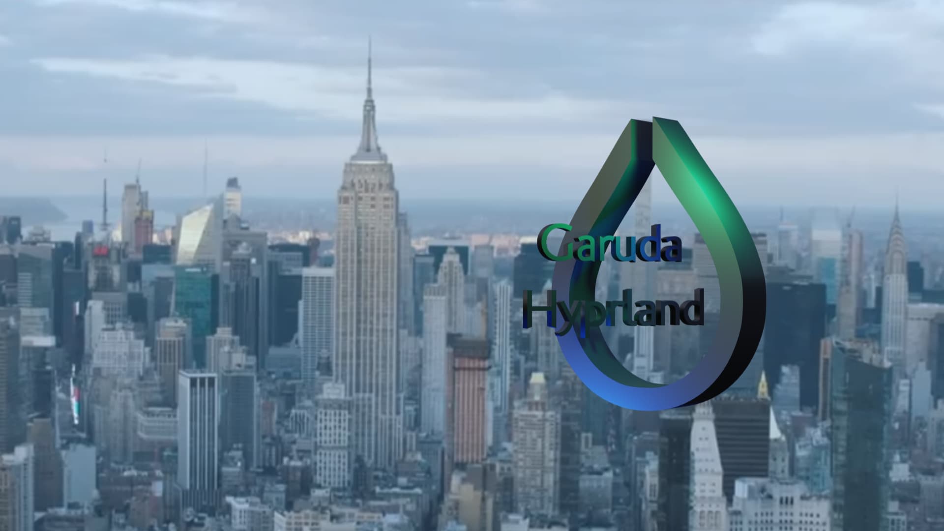

https://iso.builds.garudalinux.org/iso/community/hyprland/230625/
Now with SDDM login manager

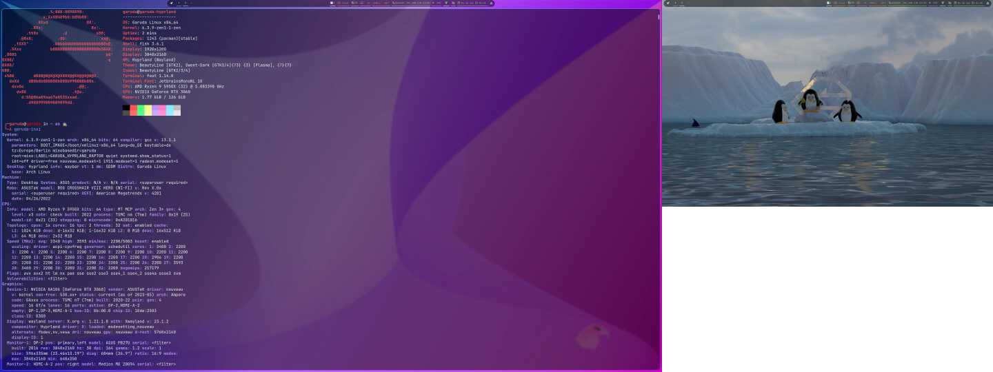

So I'm guessing these hyprland builds do not have the nvidia fix in them
There is a fix?
It was only booted, the display settings were not changed.
Free driver works, NVIDIA failed.

Nice to see the new login manager , it looks so cool!!!
