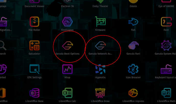

After reinstalling the Garuda Hyprland edition, I launched garuda-network, entered the password, and it worked normally — I could configure it and keep it running without any issues.
However, once I close the program, after a few seconds (sometimes up to a dozen seconds), the screen goes completely black. The Caps Lock key still responds (LED toggles), so the system itself is not fully frozen.
The same thing also happens with garuda-boot.
Since the screen goes black, I don’t have the technical ability to further diagnose the cause. I’m just reporting this issue here.

When I close either of these two programs with mod+q, the screen goes black after a few seconds.
The own apps from garuda.
These are both qt5 base apps. (my knowledge)

I suspect the launch method might be the cause—they both use:
Exec=dbus-run-session -- /usr/lib/garuda/pkexec-gui garuda-boot-options Exec=dbus-run-session -- /usr/lib/garuda/pkexec-gui garuda-network-assistant

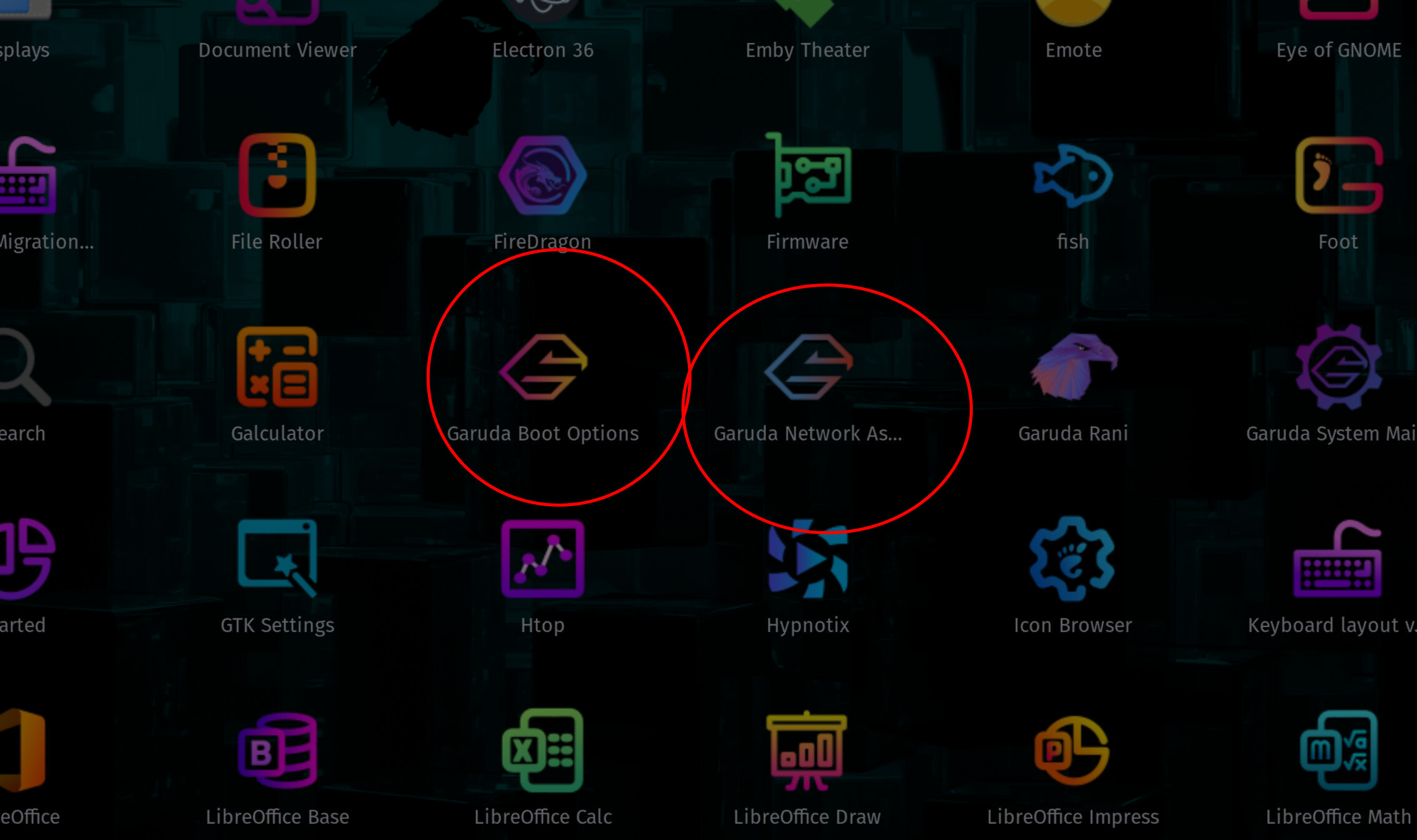

Isn’t this program just an easy thing to find from the launcher? just skip it for the time being.
Heya, I’ve applied a potential fix to this issue. Please update your system and check if the issue persists. Thanks.
Now, I click the app icon, it asks for my password, and after I enter it, nothing happens,the app doesn’t run.
What launcher do you use
bind = $mainMod, D, exec, pkill wofi || wofi --normal-window --show drun --allow-images
bind = $mainMod SHIFT, D, exec, nwg-drawer -c 8 -is 60 -spacing 23
Sorry, I’m not familiar with this format. What process/binary does the actual launching?
