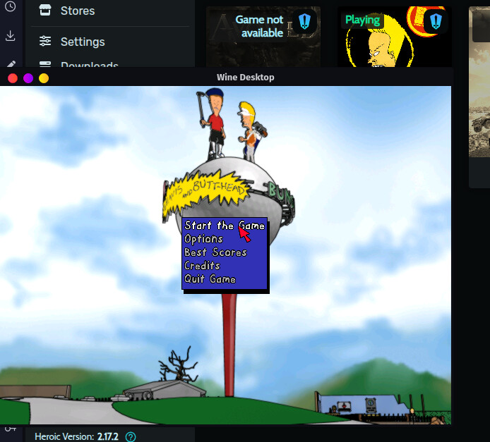

I have wine-wow64 installed from AUR already because my other Games. Also i have installed ¬ wine-mono¬| ¬wine-gecko¬| ¬wine 10.12¬ and ¬winetricks¬. I have the Game also as Disk. I did installed it with Heroic Game Launcher and it worked . Just the screen is small but i think i can change it with winecfg option.
This is probably The Way. I try latest-und-greatest aur wine. Thanks for the tip.
