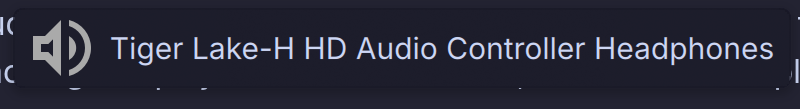

  • I get the popup overlay saying “Tiger Lake-H HD Audio Controller Headphones”

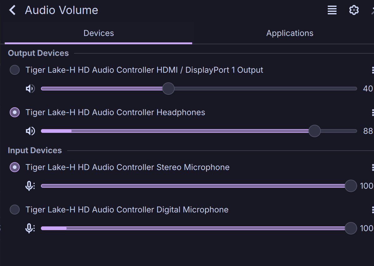

  • in volume control (Audio Volume), the sound level bar that corresponds to the headphones starts moving as I play music in Audacious, as if music was playing on the headphones

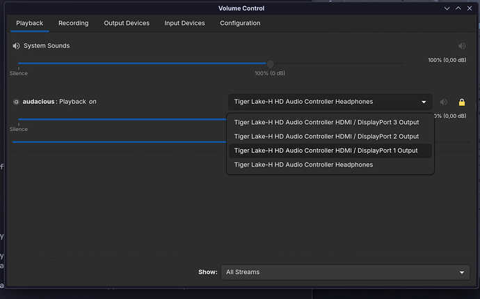

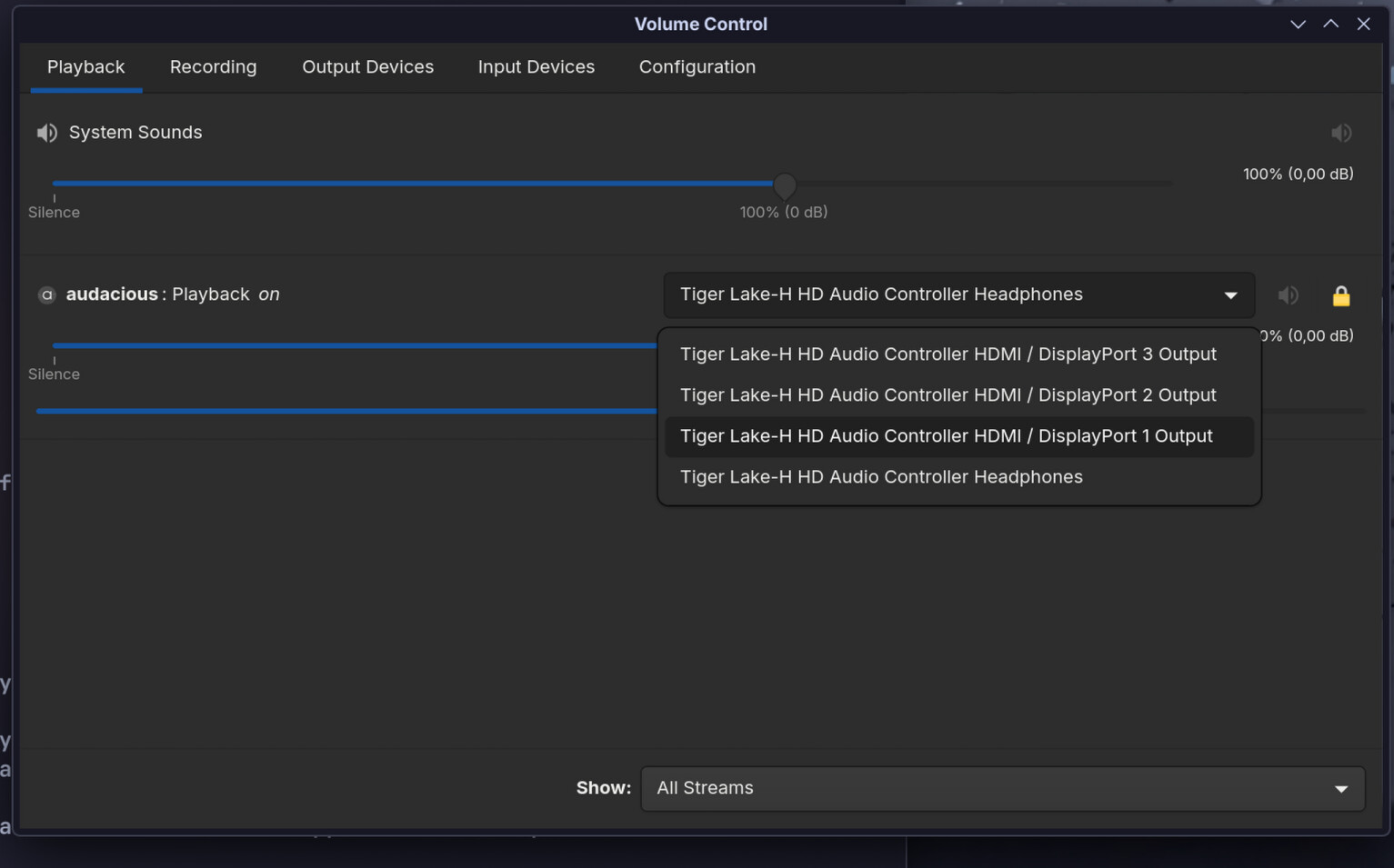

  • [EDIT] pavucontrol - Keeping my headphones connected, if I switch to “1 Output” I get sound on the speakers, but if I select “Headphones” there’s no sound anywhere
Popup when I connect the headphones:
Audio Volume showing the sound level bar moving for the headphones:
[EDIT] Pavucontrol:
