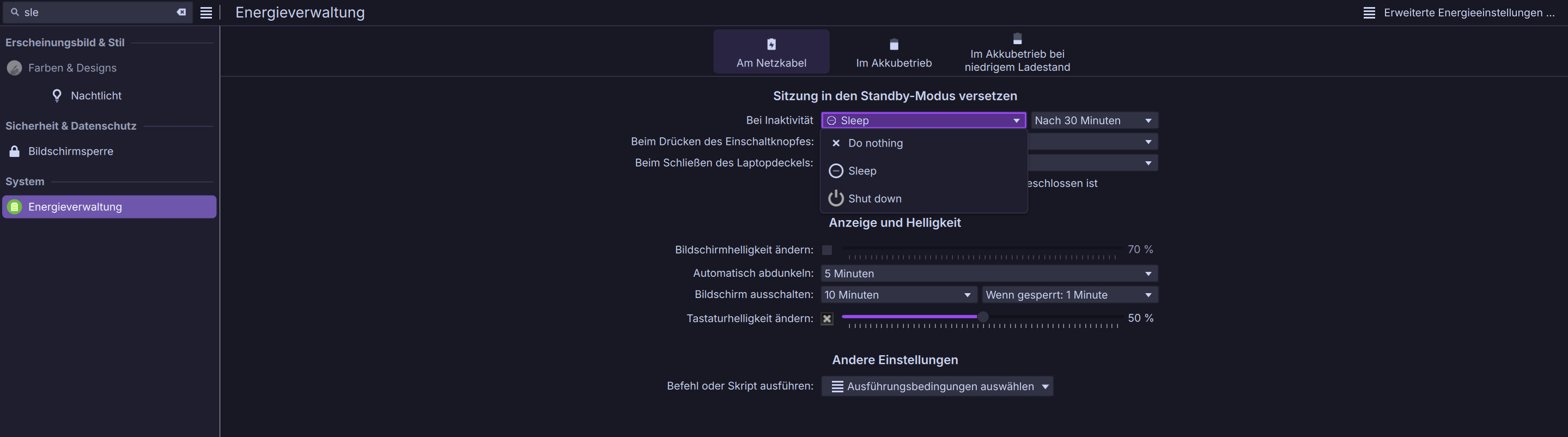

At least you can disable sleep in system settings :slight_smile:
yeah, to be honest i disabled all settings for sleep ,hibernate , desktop turn off ,dimm or screensaver at all. our newer Pc1s or Laptops dosnt eat electrical power much like the 90s.
So i let it run all time is better for the electronics anyway. (had old ibm server running 24h/7 they run longer as up and downs on pcs only my experiences) I shut it down only if i need if im off for few days from home. Didnt see those Post lol.
