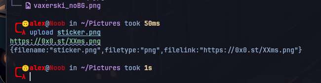

This one is a super simple script to upload a single or multiple files on 0.0st website it can also a json data of that files with name if need super handy
itโs upload your file like
i made this because i want to apply skin on my minecraft id from server and i didnโt find anywhere wher i upload my skin easily
