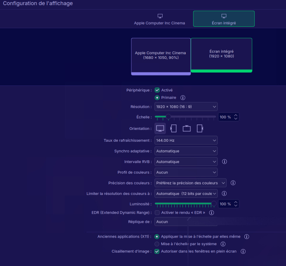

The problem seems almost solved!I don’t know how, but plasmashell is no longer misbehaving when idle.
shayaknyc, I think you should update to see if the issue is also resolved for you…
The only thing I tried to do after the updates was, in the case of a dual-monitor setup, to switch my primary screen with the second one! And everything seemed to go back to normal. Do you think that could have been the cause?
The problem is not entirely resolved because each time I reconnect, it seems I have to repeat the process of selecting my primary and secondary screens. :neutral_face:

It’s still not great! I’m still forced to switch between the primary and secondary screens, in my case! :sweat_smile:
