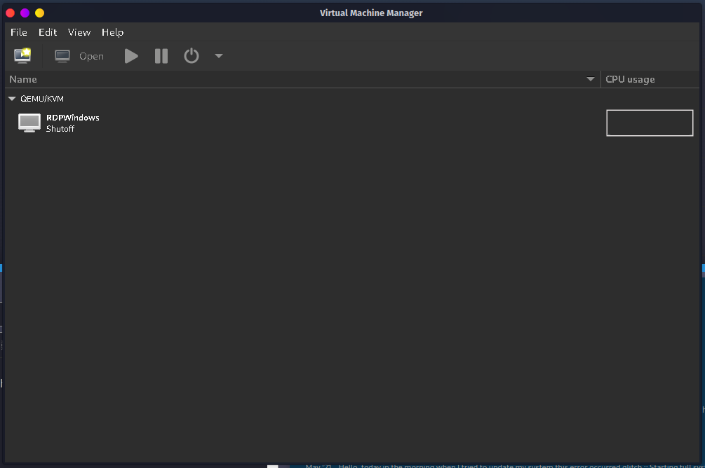

This is a screen shot before wayland this is on x11 without ishu you can see the theme

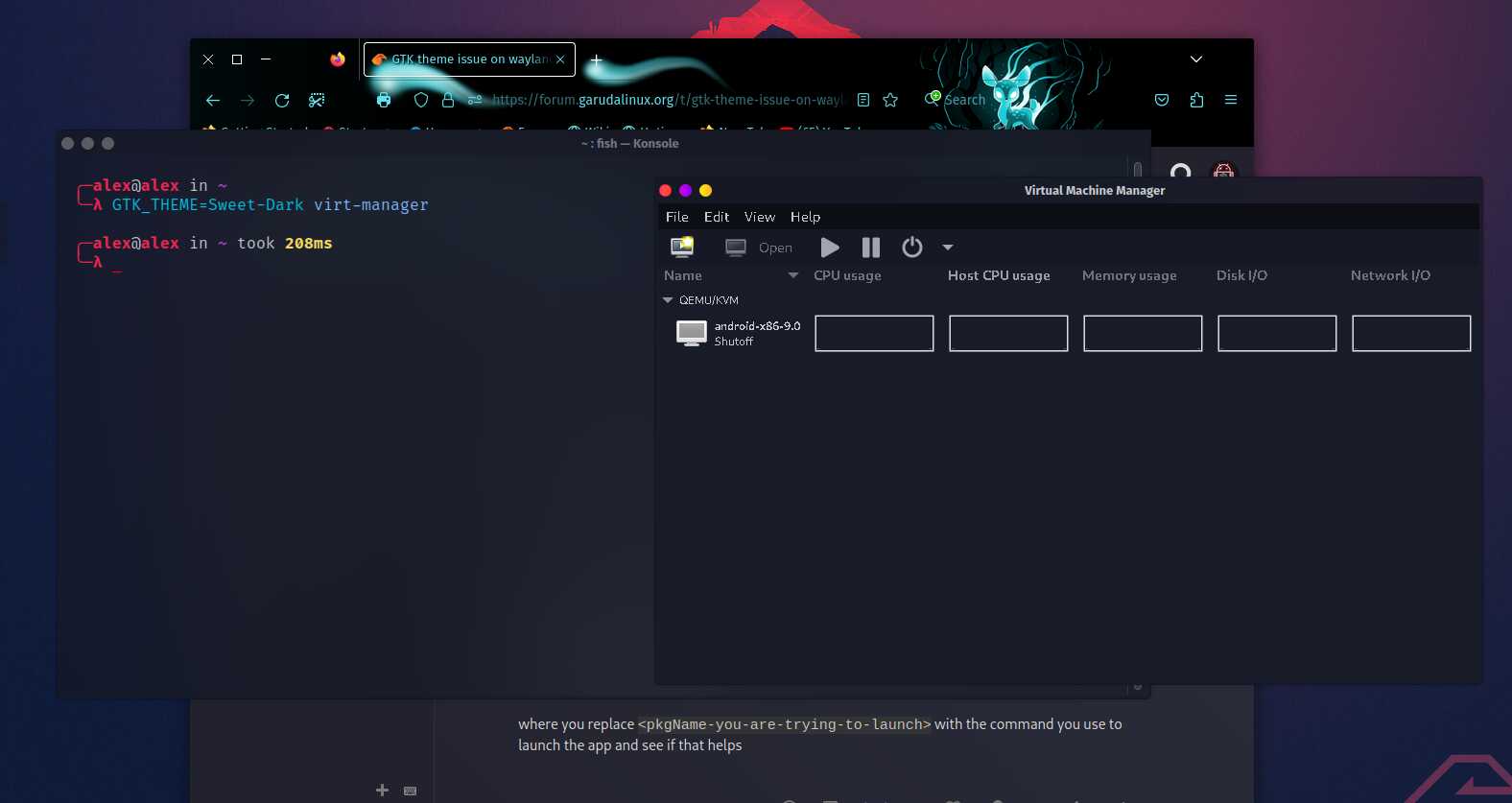

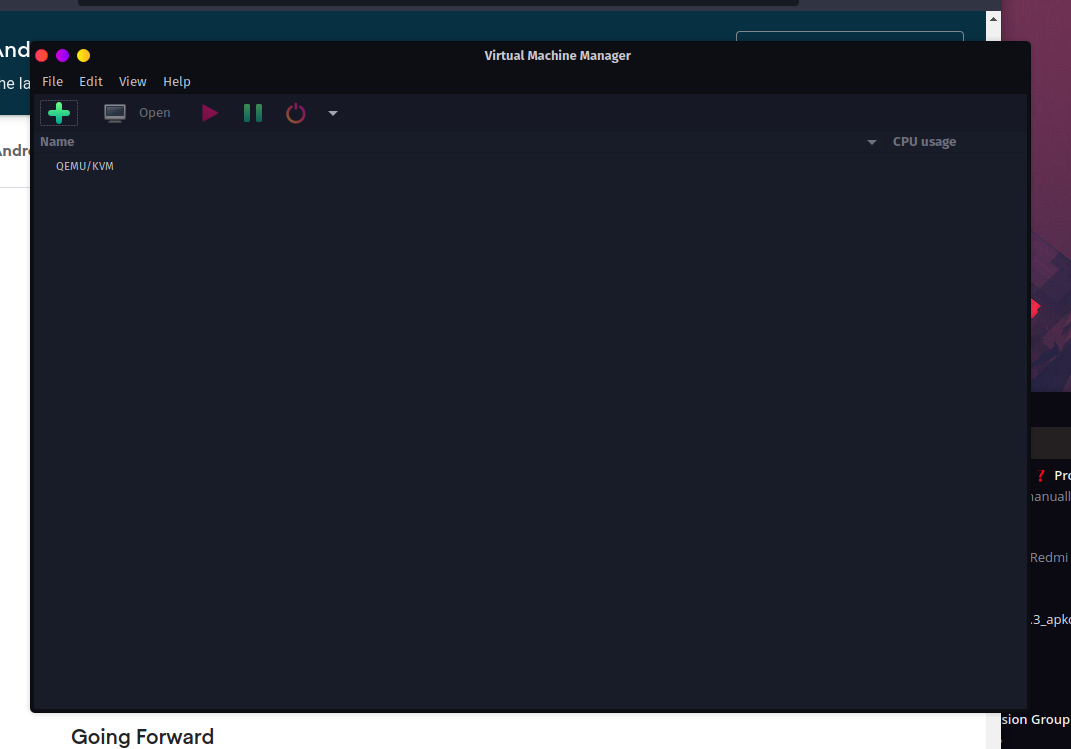

And this is a screenshot of in wayland with the ishu in here you the theme is removed it self

the ishu was i cun't change the theme but in some apps theme and front style and size was changing on wayland

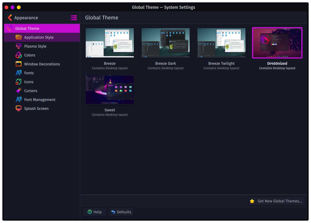

In your settings-->appearance
Can you ensure the following defaults are there as they should:
  1. The Global theme is set to Dr460nized
  2. The application style is set to kvantum-dark
  3. The Plasma Style is set to Dr460nized
  4. The Colors is set to sweet
  5. The window decorations to sweet dark
  6. The Icons to BeautyLine
If they aren't click on them to set them as such and apply. Then reboot to verify.

Also is this happening with only one app or is it system wide? If it's with only one single app can you launch it from terminal like this
GTK_THEME=Sweet-Dark <pkgName-you-are-trying-to-launch>
where you replace <pkgName-you-are-trying-to-launch> with the command you use to launch the app and see if that helps

after launching with that argument it like this but the front style and the mouse curer still the same like black and big
but when i launch this app normally it same as before again

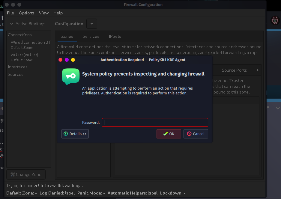

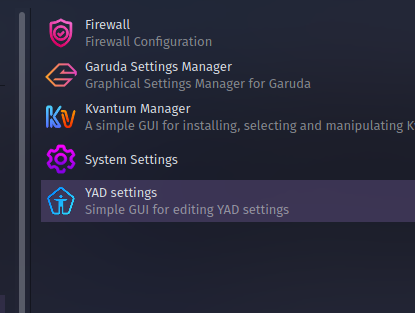

only not kvm its happend with this also
the YED settings softwere
and firewallid
