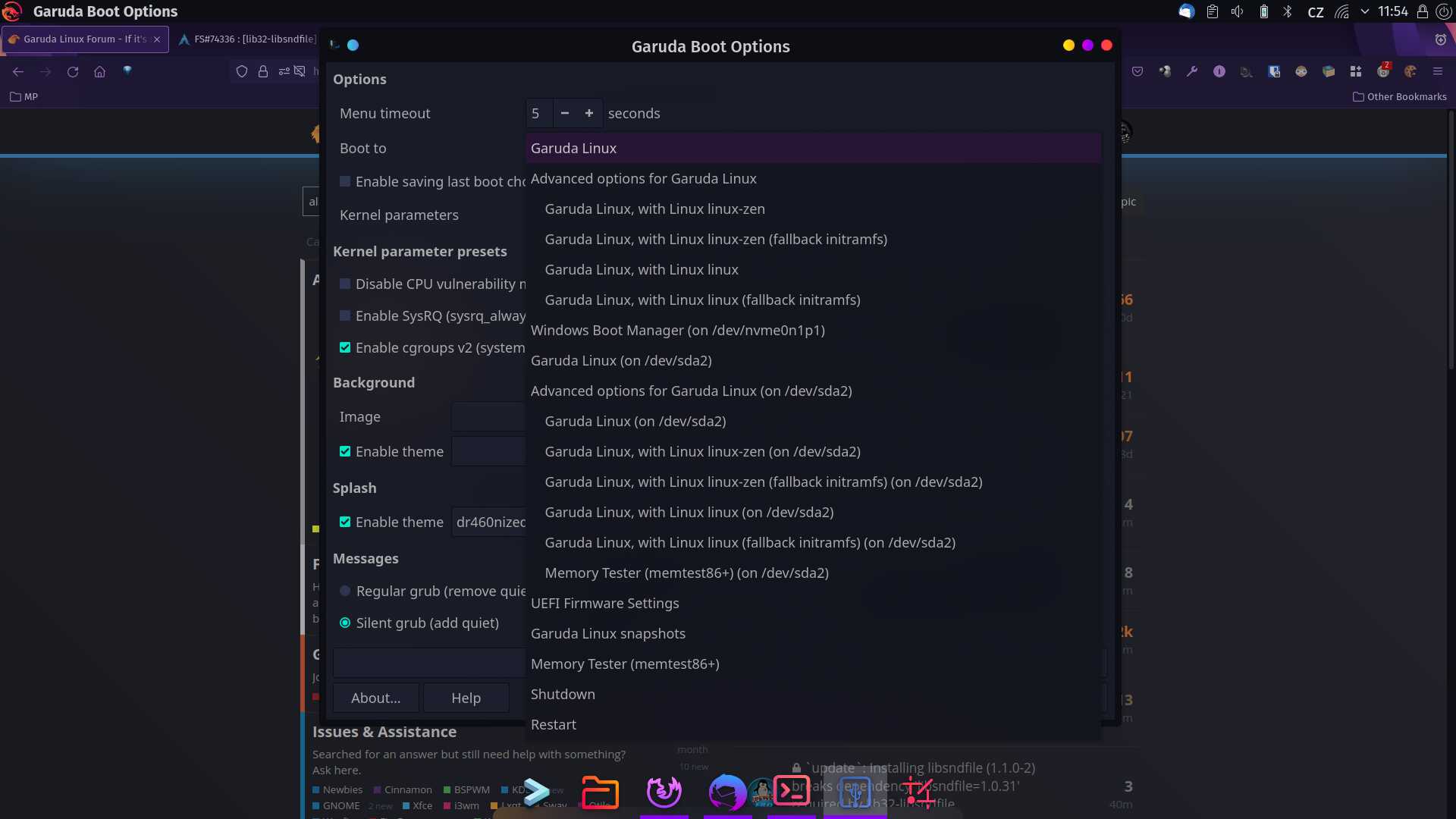

Hello again.
After recently updating my system and rebooting, Garuda Linux is now showing twice in the boot menu. I've tried removing the second options in Garuda Boot Options, however I've been unable to do so. Both options do the same. It's not really a problem, it's just and aesthetic issue. I've been used to solve this issues by installing Grub Customizer back on my Fedora, however after trying to install it, I would remove official garuda software, which I don't want to.

And screenshot of Boot Manager options:
Thanks in advance for any help!
Auch, this issue returns every now and then.
I remember several topics about it.
The only interesting solution I remember (there might be others) is:
Thanks for your advice. I've solved it for now by (very carefully) editing /boot/grub/grub.cfg file and removing the entries. I will hope that in next few updates the issue will get resolved.
