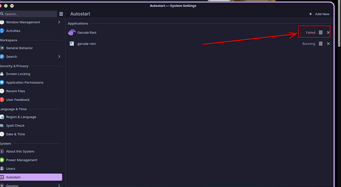

Garuda-Rani is failed to autostart after every boot up
I added again and again the app from “+ Add New” but it is not opeing after bootup every time.

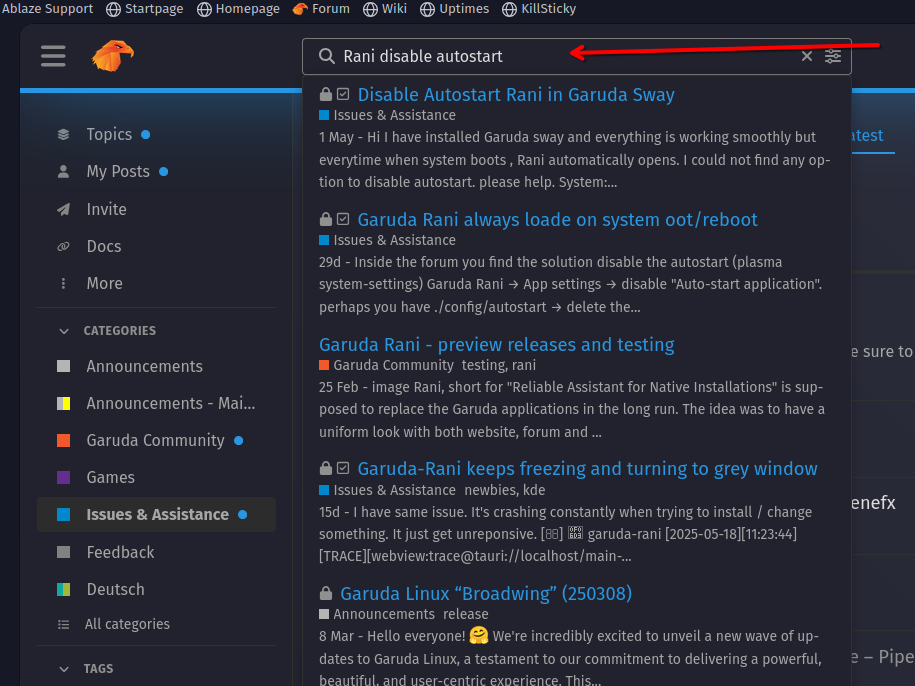

Did you searched for it in the Forum here? Just as info and reverse it ?
i read that post u mentioned… i did everything including the post what covered (i reversed to autostart) also checked in my .config
ls .config/autostart/
.rw-r--r-- 157 arij  2 Jun 11:13  garuda-rani.desktop
.rwxr-xr-x 401 arij  8 Mar 01:55  initial-setup.sh
.rw------- 287 arij  1 Jun 05:35  org.garudalinux.rani.desktop
so i find all things are ok and should be worked but its not working thats why. any idea? or solution?

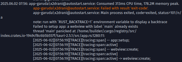

Hi,
i can approve this behavior. I deleted the garuda-rani script file and rebooted. Garuda Rani was starting after the login no problems. If i reboot it didnt work again. I checked the autostart and the script was again created in the Folder. So just for fun i deleted it and reboot it worked again. Seems like Garuda Rani create this file after the successful start after login and this causes the behavior.

i can see this here but i cant copy or paste it may it helps @dr460nf1r3
It’s likely that KDE and the app itself create 2 different files for autostart. As for the crash.. it’ll very likely be fixed with the rewrite that’s currently ongoing. I’m dedicating resources here instead of fixing this one, that’s more useful imo. Just make sure to not have two autostart entries for the time being?

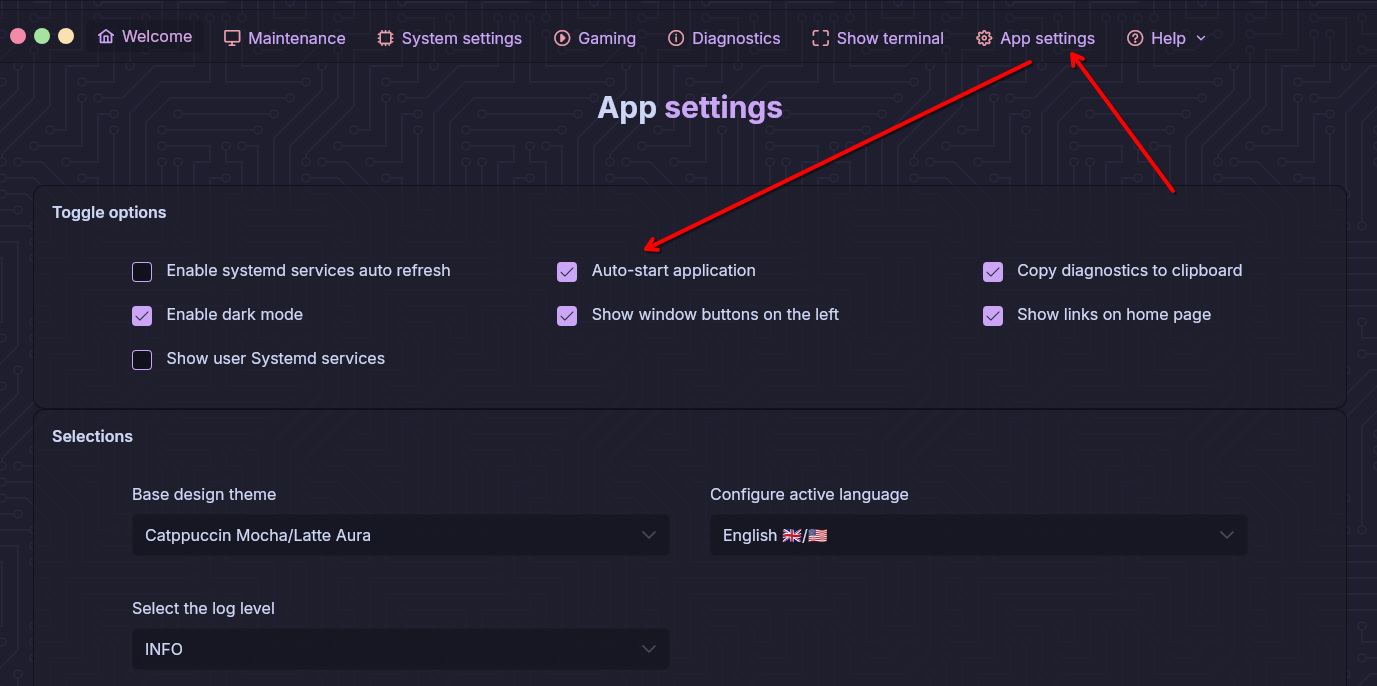

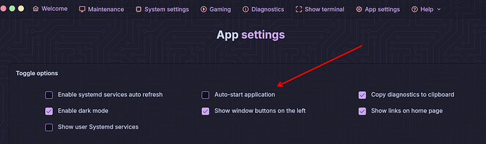

I did test a bit now with those 2 files to delete it single of them and reboot no effort at this but i found out just simple thing uncheck the autostart in Rani Settings and it will work. :wink:
Do not delete any files in the .config folder this uncheck remove the created file from Rani in this Folder.

Aaah yes that makes perfect sense haha. Autostart is a setting. If it’s true, Rani will restore the state at startup in case the autostart file got deleted and vice versa:
const currentAutoStart: boolean = await isEnabled();
      if (currentAutoStart && !settings.autoStart) {
        this.logger.debug('Syncing auto start setting with system: enable');
        void disable();
      } else if (!currentAutoStart && settings.autoStart) {
        this.logger.debug('Syncing auto start setting with system: disable');
        void enable();
is this the soultion?? need an update? or what? pls elaborate

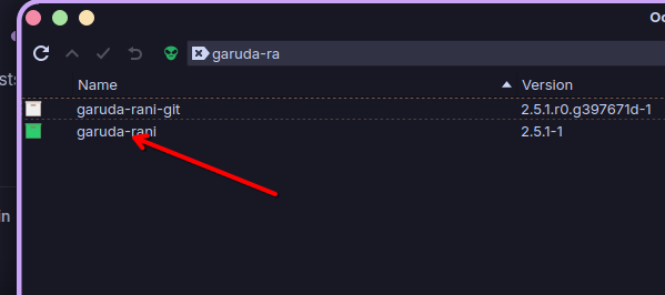

What I did is :
Just reinstalled and enabled auto-start from App Settings in Garuda-Rani.

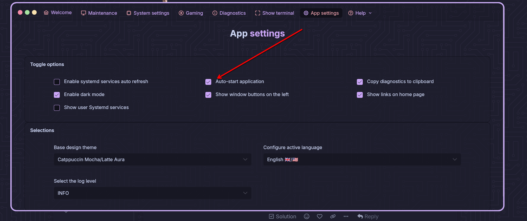

If it stop working again uncheck it in rani settings or disable it that it is not glowing purple like it shows in my picture.
You didnt have to reinstall the whole system.
No i didn’t reinstalled the whole os. i just reinstalled garuda-rani.
