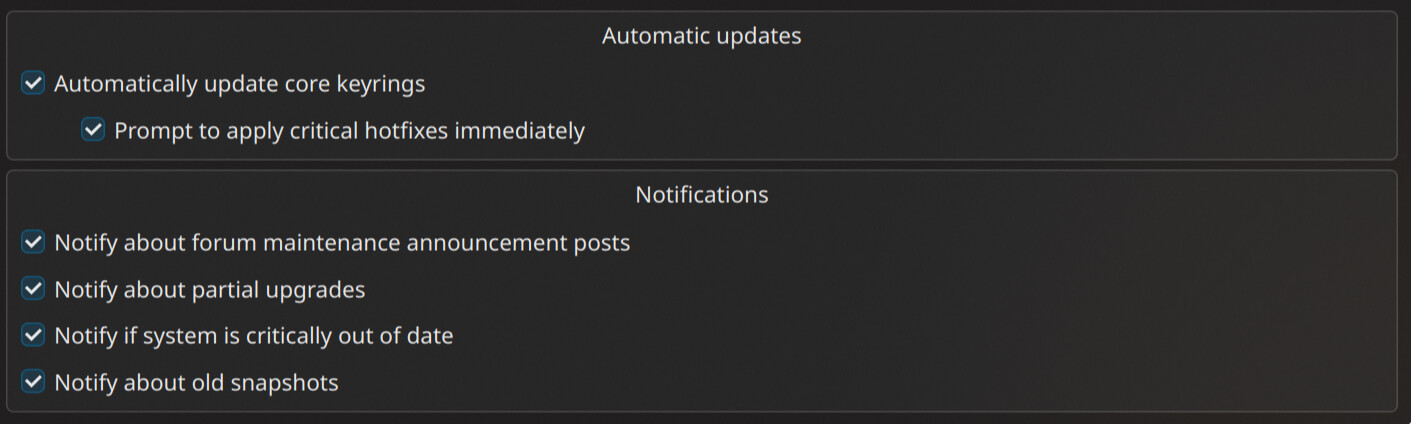

Hi,
I have some issues with using Hyprland on my Garuda Linux installation. For context, I have a Garuda Linux Dr460nized installation, on top of which I installed the ML4W dotfiles. So, I have both KDE and Hyprland sessions available on my system.
My issues happen when I log into a Hyprland session. Namely:
  1. the Garuda Maintenance notifications (e.g., about deleting old snapshots) don’t show up in my Waybar’s system tray at all. If I log out and log into a Plasma session, the notifications are there
  2. when I want to restore a Snapper snapshot, I don’t get a dialog window asking whether I want to roll back to that snapshot, after selecting it from the boot menu and logging into Hyprland. I have to log into a Plasma session for the Snapper prompt to appear and to restore the snapshot successfully.
I understand it’s rather unusual to have Hyprland installed alongside KDE. I use Hyprland as my daily driver and KDE as a backup in case something breaks and I can’t access my system anymore. There have been no major issues outside of the 2 I mentioned above.
In case it helps, here’s a screenshot of my Garuda System Maintenance settings:
Thanks for the help!

No need to be so critical. I’m asking for help, not expecting the Garuda team to do anything. If I can get some assistance from here, fine. If not, I’ll just continue searching for solutions.
I’m assuming that getting maintenance notifications running involves maybe executing some app at startup or enabling a service. I just want to see if maybe it’s that simple of a fix, hoping that someone that maintains the Garuda Hyprland spin might know more about this.
And maybe the Snapper prompt at logjn works similarly?
The notification daemon is mako, idk maybe adding snapper to exec once on hyprland config. Probably a crontab. Those are options i’d look at., sorry if I seem critical.
