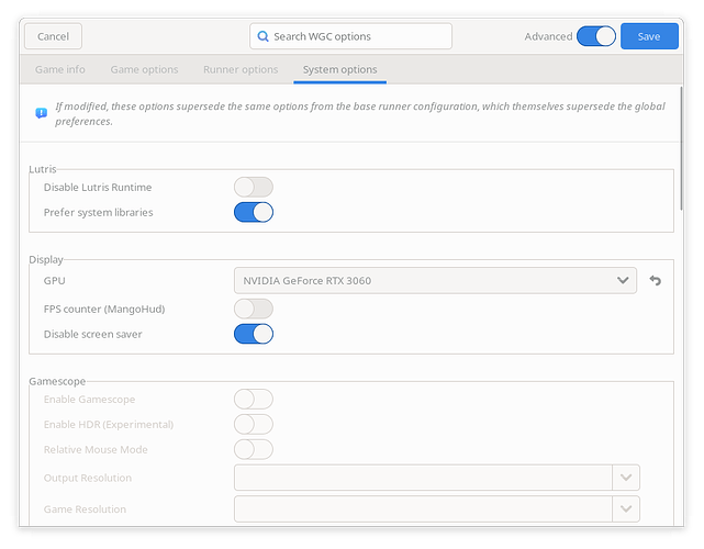

I cant help to much but i recommend using lact to track gpu usage an performance.
In Lutris I had to manually select which video card I was using, for a different game. You might want to try the same thing and see if it helps.

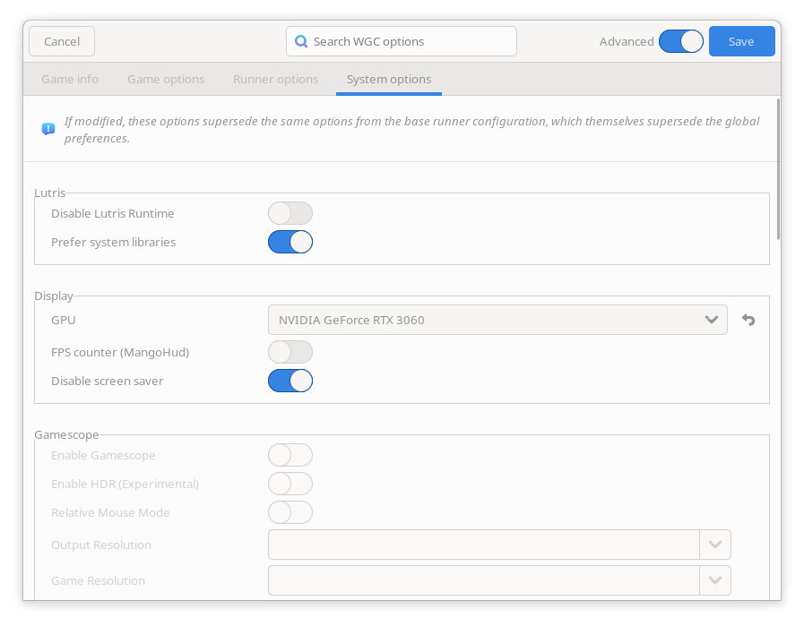

I did that, I know all the ins and outs of Lutris, at least within the GUI. That’s why I resorted to bugging y’all lol
And even though I have my dGPU selected, still runs on iGPU
