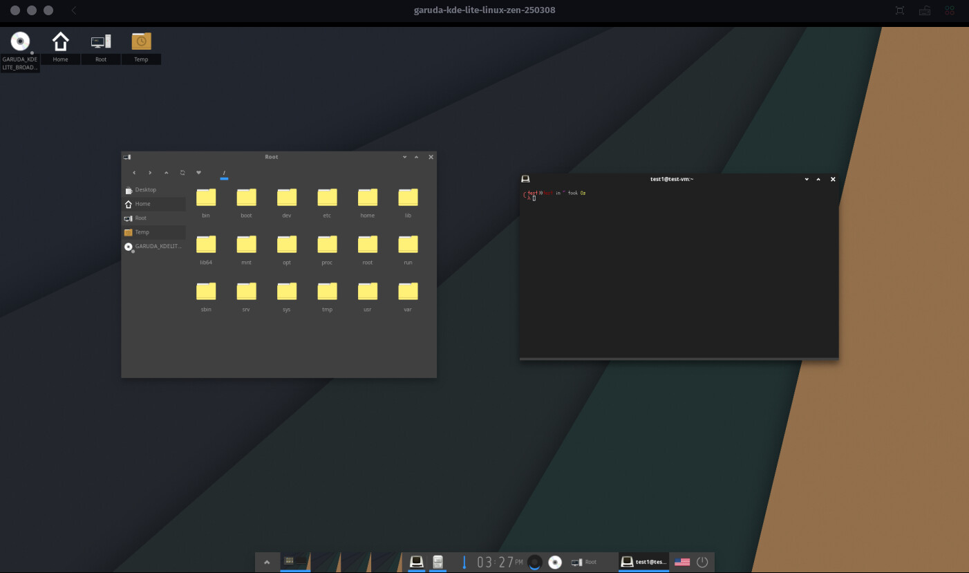

@SGS got it…quite simple, but you might want other packages like terminology and rage.
sudo pacman -S --needed terminology rage

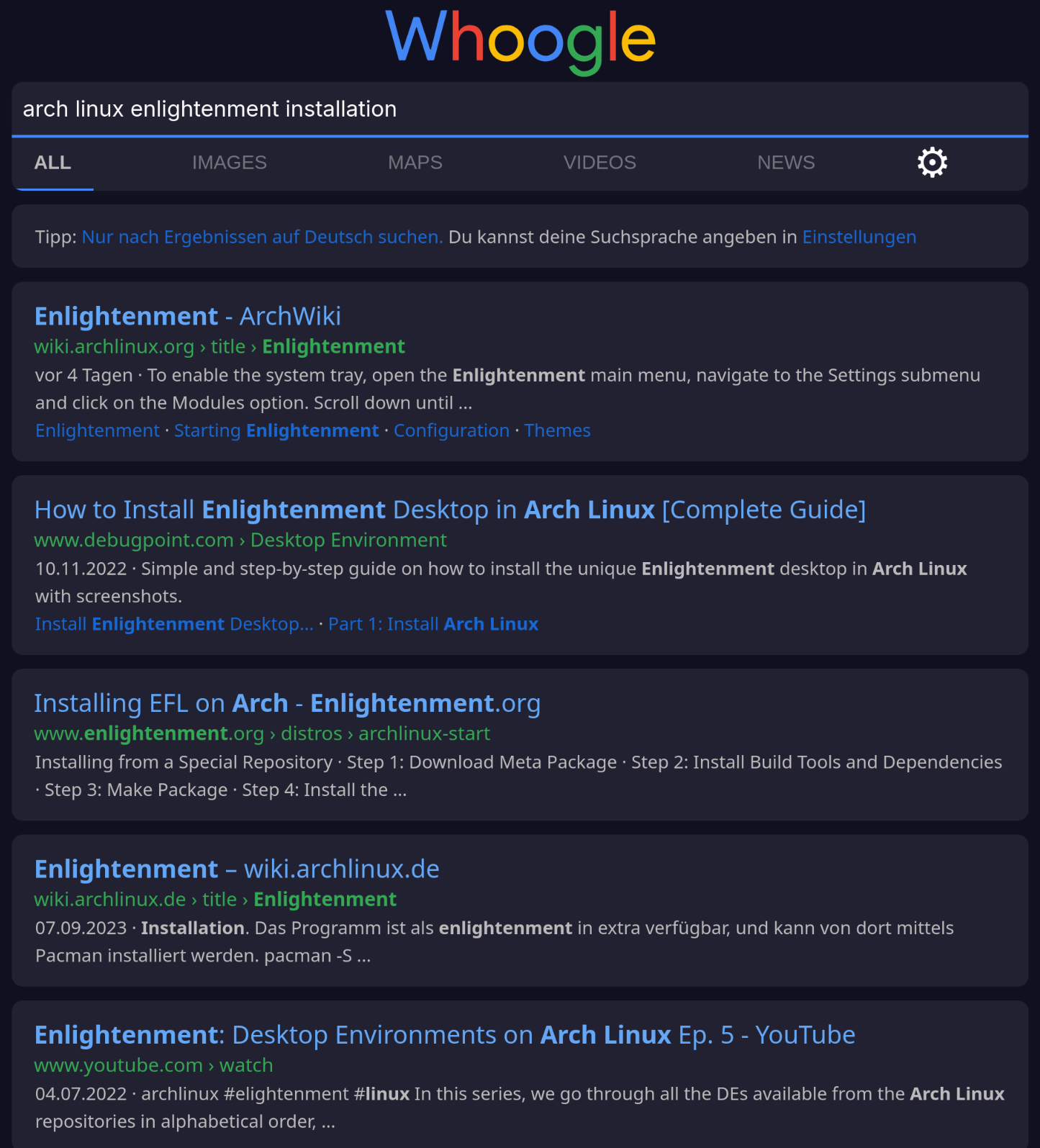

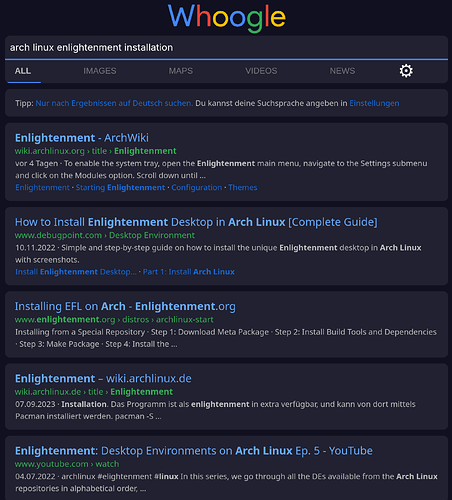

I found this article How to Install Enlightenment Desktop in Arch Linux [Complete Guide] - part 2 looks interesting.

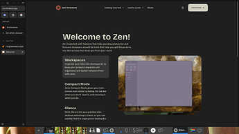

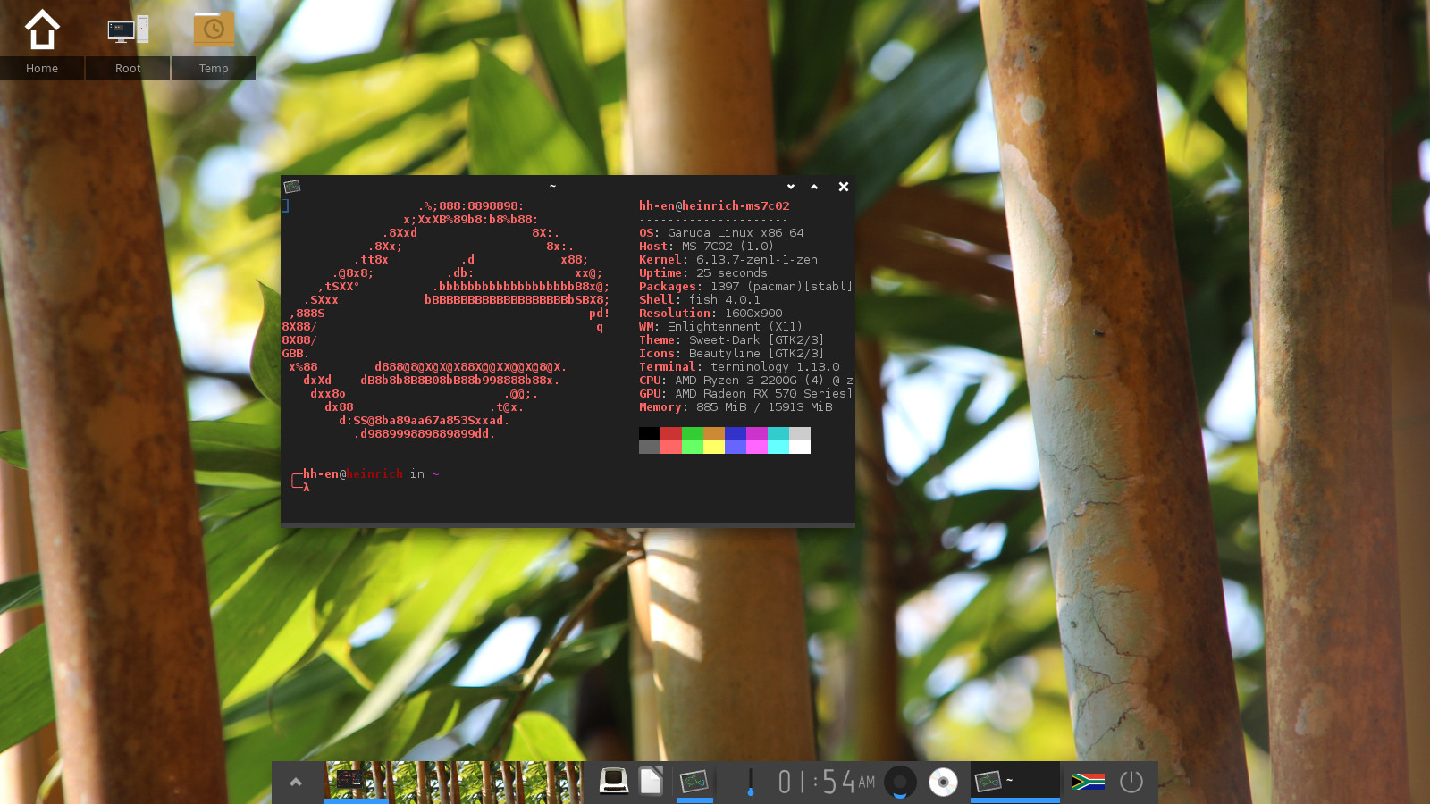

I tried it. It’s nice. It actually fits very well with Zen Browser.
It’s very light, almost 200MB RAM less than Cinnamon.
