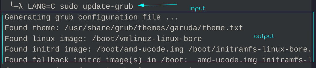

Please post
cat /etc/default/grub | grep GRUB_CMDLINE_LINUX_DEFAULT
as text.
Also complete in and output from
sudo update-grub
GRUB_CMDLINE_LINUX_DEFAULT="nvidia-drm.modeset=1 quiet quiet splash rd.udev.log_priority=3 vt.global_cursor_default=0 resume=UUID=65dc39b3-b042-4657-9b4c-ce41537ff958 loglevel=3"
/etc/default/grub: line 1: nvidia-drm.modeset=1#: command not found
in terminal

I think there is no point in guessing around, post the input and output as text so we can see where the problem is.
what do you mean? when I type into the command line sudo update-grub it just says that, that nvidia command does not exist. I even deleted that command from the land, and it still says that
somehow the file got messed up and now it is saying command grub does not exist
 ╭─sgs@i3 in ~ took 15s
 🕙 05:54:27
 ╰─λ LANG=C sudo update-grub

You should understand that we are not psychics, we don't see what you see, just post the terminal in and outputs as text.
sudo update-grub
