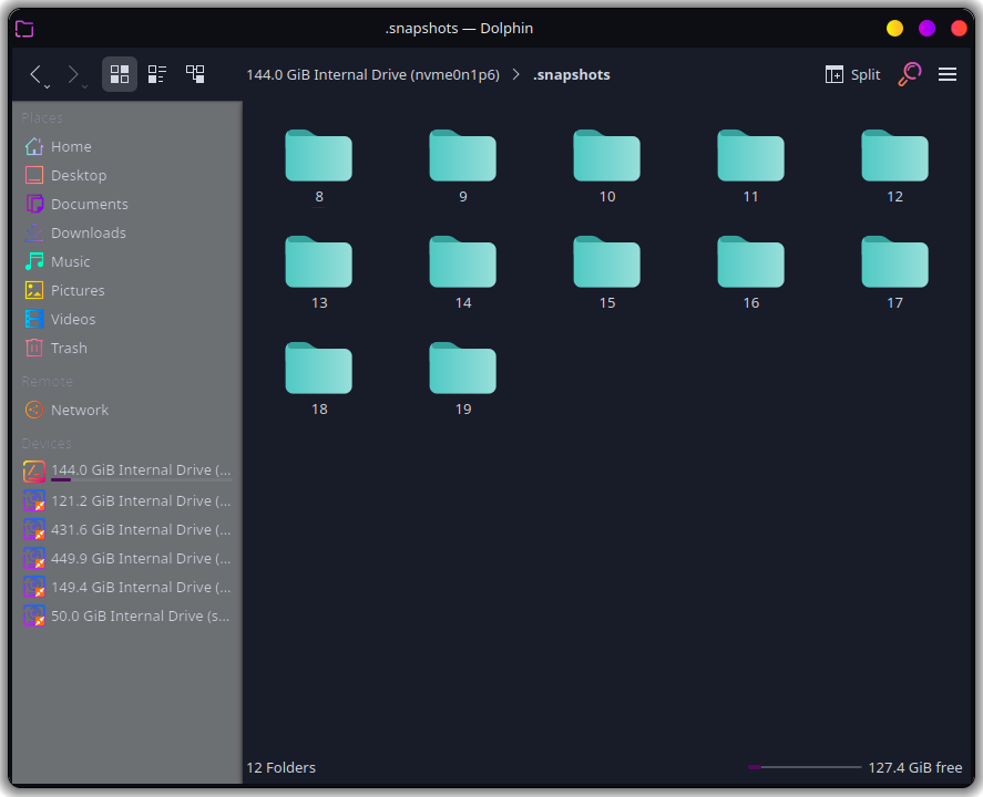

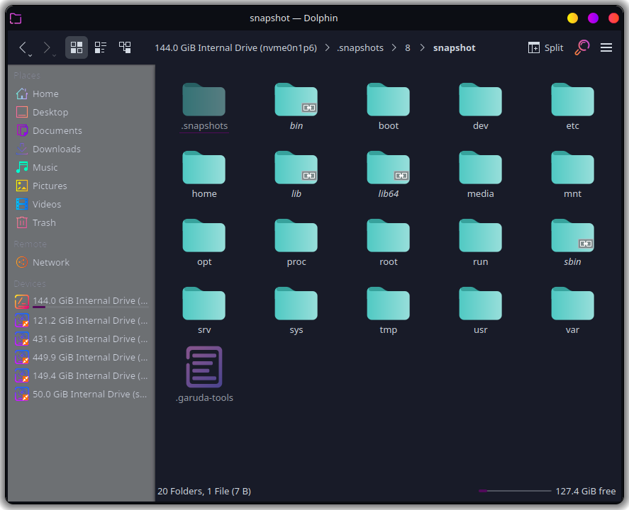

and yes it take snapshot of hole i system except(home) i send you screen shot of (.screenshot) folder in root i just install vokoscreen and some small package and i get this huge folder on root

Yeah , I use 50 GB for Hyprland and dolphin show me for .snapshot 83 Gb in use. So.

ok if you say was true so
how this happend
look at address bar
file size reporting from the snapshots folder is always incorrect.
i have Garuda installed to a 40gb partition and have seen the file size report over 80gb in use, which is objectively impossible.
the older a snapshot is, the more space it takes due to packages being replaced with newer versions and the snapshot keeping the old one for restoration.
delete your old snapshots and quit getting your underwear bunched over read/writes.
i have a 14 year old SSD that is in perfect health. (Kingston ftw)

you right about size of dolphin show wrong number when i check size of root folder on proprties its show 128Tib and thats in possible my root folder is 144Gib
so it can be snapshot like link of real file?
if not how i check size of .snapshots
open snapper tools, make a manual snapshot and then delete the old snapshots you won’t need.
do this regularly.
