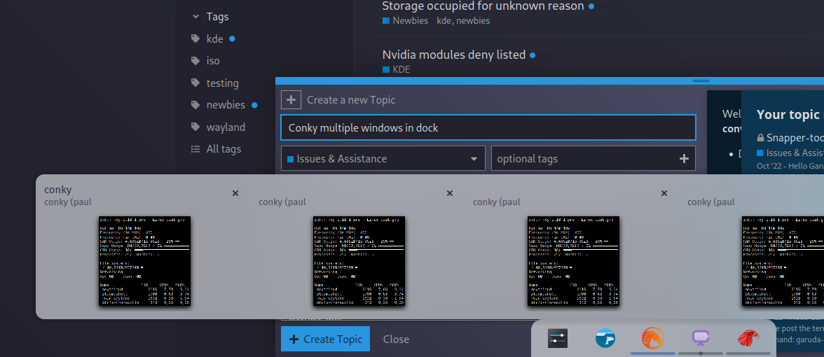

Conky multiple windows in dock
Conky displays multiple instances of itself in the dock, and is only shown on desktop when clicking on one of them.
Also, I’m unable to close them

It starts automatically with Plasma (I think). If I start it also from terminal, this is the output:
╰─λ conky
conky: no personal or system-wide config file found, using builtin default
conky: desktop window (49f) is root window
conky: window type - desktop
conky: drawing to created window (0x2600001)
conky: drawing to double buffer
However, that changes nothing in the Dock - hovering the mouse over its icon, the little preview windows fill the screen from edge to edge.
In Plasma System Monitor, 10 Conky processes are running. Calling conky from terminal adds another. Attempting to close on of the Conky windows from dock does nothing.

As a desktop widget, Conky shouldn’t have an icon in the dock at all. I tried to block it in the settings for the dock, but can’t figure out how to get into them. Right click only offers settings for the app that I’m pointing at.
