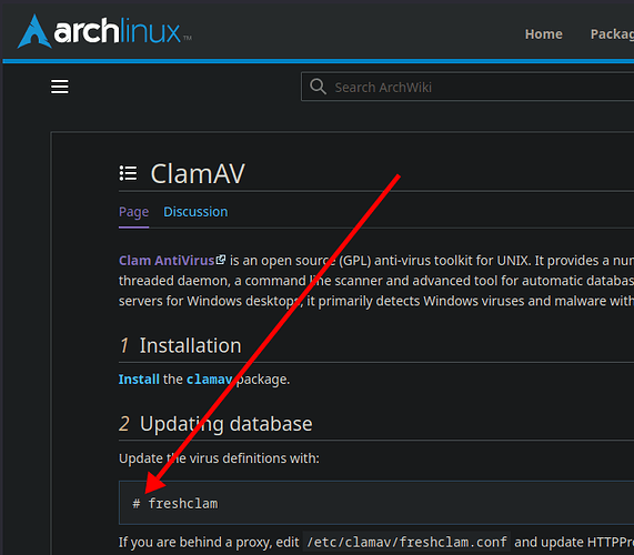

I did figure out why the ownership reverts like this, but before we get into it I think it should be noted that the most typical way to run freshclam is with sudo or as root.
See also the ClamAV docs here: FreshClam (Signature Updater) - ClamAV Documentation
If running Freshclam as root (or with sudo), then Freshclam will try to automatically switch to run as the clamav user, or whichever user is specified as the DatabaseOwner in freshclam.conf.
Considering this behavior, the default ownership (clamav:clamav) is appropriate.
