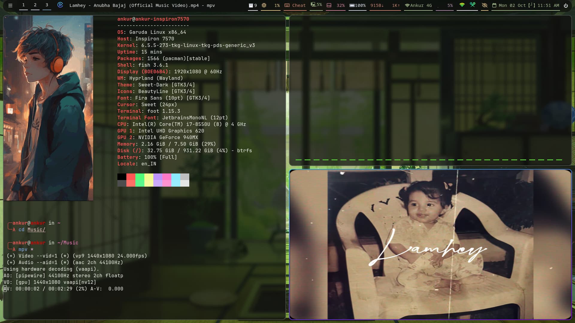

cava is now running but there is a problem, it seems like cava only detects sound when I install or uninstall ALSA and don’t restart , when I restart it again the bars of cava stop moving up and down :
It seems like something (maybe some components of ALSA itself) gets activated when I install or uninstall the ALSA support . But when I restart those components may not get loaded .
