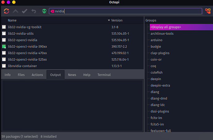

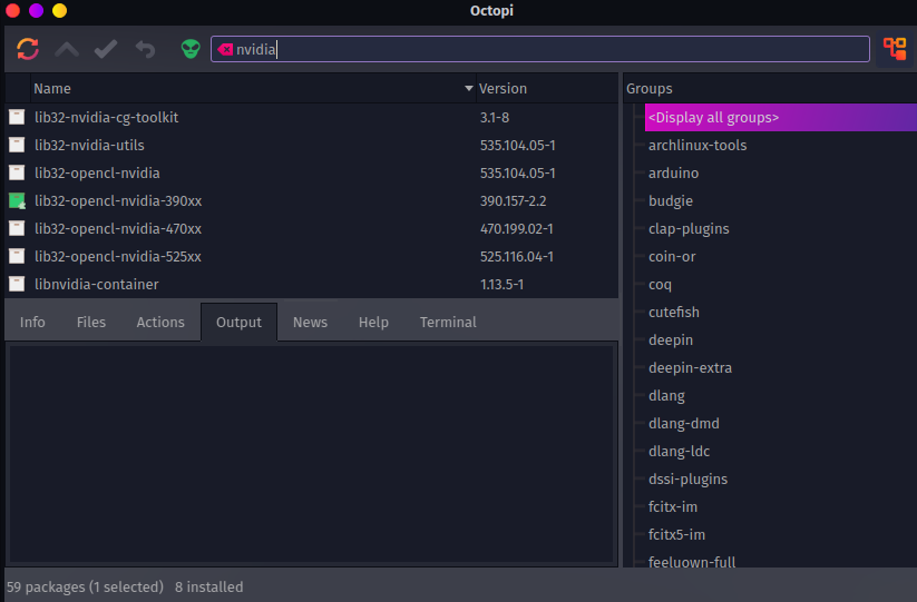

OK, but, I search in Octopi and still appears
lib32-opencl-nvidia--390xxx
So, can I remove this and install again nvidia 470 drivers and dkms? what is the command in order to install all correctly?

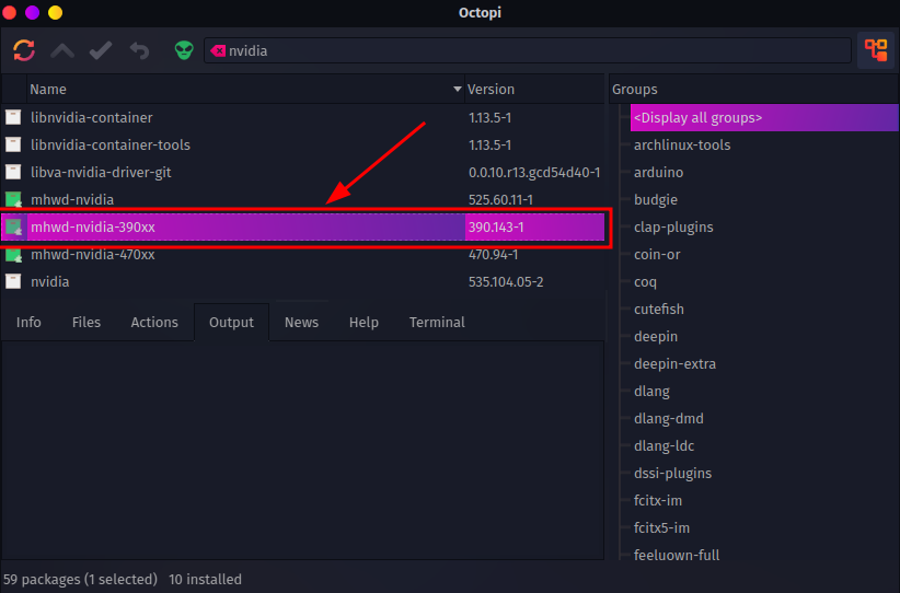

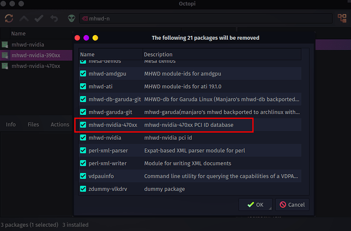

But, all that, after I remove nvidia-390xxx wwith octopi, .... but:
If i want to remove nvidia-390xxx it seems that will remove also 470...
And all another important stuff...

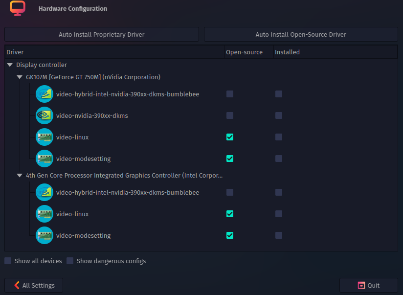

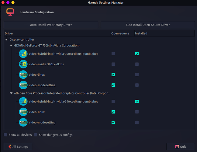

Hardware settings still shows 390:
... any help?

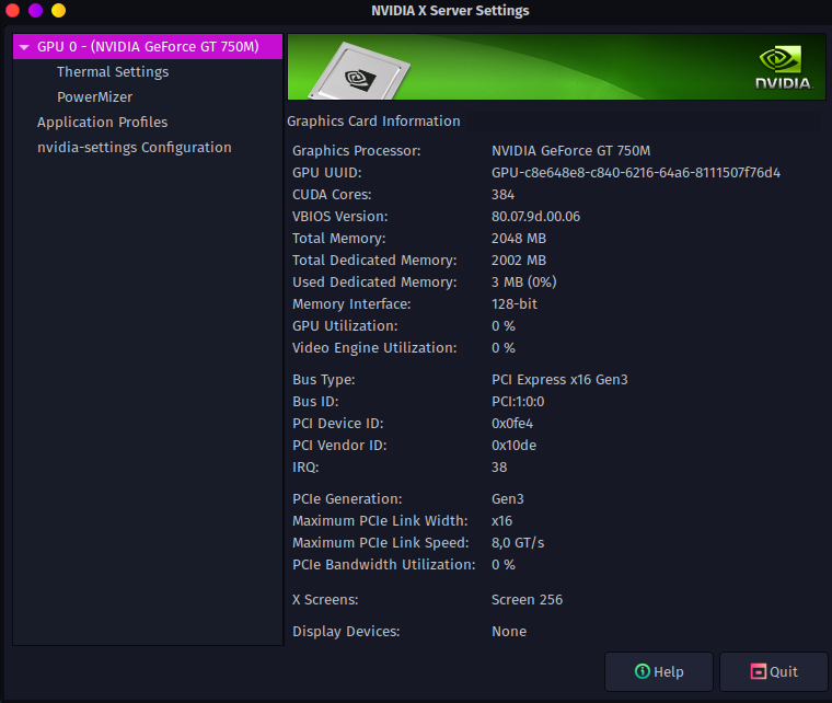

Check also
nvidia-smi
sudo nvidia-settings

╰─λ nvidia-smi
Wed Sep  6 13:20:48 2023
| NVIDIA-SMI 470.199.02   Driver Version: 470.199.02   CUDA Version: 11.4     |
| GPU  Name        Persistence-M| Bus-Id        Disp.A | Volatile Uncorr. ECC |
| Fan  Temp  Perf  Pwr:Usage/Cap|         Memory-Usage | GPU-Util  Compute M. |
|                               |                      |               MIG M. |
|   0  NVIDIA GeForce ...  Off  | 00000000:01:00.0 N/A |                  N/A |
| N/A   57C    P8    N/A /  N/A |      3MiB /  2002MiB |     N/A      Default |
|                               |                      |                  N/A |
| Processes:                                                                  |
|  GPU   GI   CI        PID   Type   Process name                  GPU Memory |
|        ID   ID                                                   Usage      |
|  No running processes found                                                 |
... and sudo nvidia-settings
╭─siegfried@siegfried in ~ took 33ms
╰─λ sudo nvidia-settings
[sudo] password for siegfried:
** (nvidia-settings:20406): WARNING **: 13:21:38.077: Unable to connect to dbus: Error spawning command line “dbus-launch --autolaunch=5c8ae36a50e04e038b95484d0e134f9b --binary-syntax --close-stderr”: Child process exited with code 1
(nvidia-settings:20406): GLib-GObject-CRITICAL **: 13:21:38.102: g_object_unref: assertion 'G_IS_OBJECT (object)' failed
ERROR: nvidia-settings could not find the registry key file or the X server is not accessible. This file
should have been installed along with this driver at
/usr/share/nvidia/nvidia-application-profiles-key-documentation. The application profiles will
continue to work, but values cannot be prepopulated or validated, and will not be listed in the help
text. Please see the README for possible values and descriptions.
(nvidia-settings:20406): GLib-GIO-CRITICAL **: 13:21:38.234: g_dbus_connection_register_object: assertion 'G_IS_DBUS_CONNECTION (connection)' failed
(nvidia-settings:20406): GLib-GIO-CRITICAL **: 13:21:38.234: g_dbus_connection_get_unique_name: assertion 'G_IS_DBUS_CONNECTION (connection)' failed
(nvidia-settings:20406): GLib-GIO-CRITICAL **: 13:23:15.898: g_dbus_connection_register_object: assertion 'G_IS_DBUS_CONNECTION (connection)' failed
(nvidia-settings:20406): GLib-GIO-CRITICAL **: 13:23:15.898: g_dbus_connection_get_unique_name: assertion 'G_IS_DBUS_CONNECTION (connection)' failed
Let's try this:
sudo mhwd -r pci hybrid-intel-nvidia-390xx-dkms-bumblebee
sudo mhwd -i pci video-nvidia-prime-render-offload

Hmmmmm, can you see what I show in Octopi?
My mistake, missing a “video”:
sudo mhwd -r pci video-hybrid-intel-nvidia-390xx-dkms-bumblebee
Done:
[🔴] × sudo mhwd -r pci video-hybrid-intel-nvidia-390xx-dkms-bumblebee

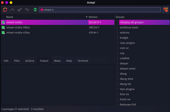

OK, I reboot.... but, in Hardware settings:
And this shows Octopi:
That looks fine, just check inxi -G to confirm you have the driver loaded. Then launch your apps with prime-run.
If you really need to see the checkbox in Hardware Configuration, I think you need to set this one up:
Those are fine. These packages are all related:
They are part of the auto-install option. You don’t need to try to remove them or do anything with them.

/var/lib/mhwd/db/pci/graphic_drivers/video-linux/MHWDCONFIG: line 35: mkinitcpio: command not found
> Successfully installed dependency video-linux
> Installing video-nvidia-prime-render-offload...
Sourcing /etc/mhwd-x86_64.conf
Has lib32 support: true
Sourcing /var/lib/mhwd/db/pci/graphic_drivers/nvidia-prime-render-offload/MHWDCONFIG
Processing classid: 0300
Sourcing /var/lib/mhwd/scripts/include/0300
resolving dependencies...
:: nvidia-dkms and nvidia-470xx-dkms are in conflict (NVIDIA-MODULE). Remove nvidia-470xx-dkms? [y/N] error: unresolvable package conflicts detected
error: failed to prepare transaction (conflicting dependencies)
Error: pacman failed!
Error: script failed!

Just stop, is what I think you should do. The correct drivers are installed. The struggle is over. These additional efforts are more likely to break something than provide any benefit.
Go ahead and enjoy your computer now. :slightly_smiling_face:
