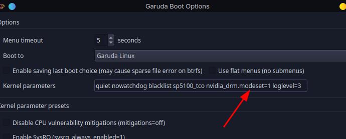

To know if you use a older driver then 560.35 you should
set the modeset=1 for the nvidia_drm` module in the kernel.
about
early boot insert nvidia_drm.modeset=1 in the default grub config file.
→ reboot pls

What does this modeset do?
It’s currently pretty stable with linux-lts and nvidia-all v550
I might have to wait on this config until kernel 6.14 and new NVIDIA drivers, see if they fix it. I’m not the only one having issues according to nvidia issue tracker.
Perhaps, but it often saved my life.
Just a hint.
Without this stuff the nvidia driver can´t funktion. If you type this, then sorry your knowledge is..hmm..expandable.

Alright I added modeset, deleted the content of /var/lib/dkms/nvidia/, uninstalled nvidia-all and re-installed repo packages.
Freezes after X11 login. Here is updated inxi
