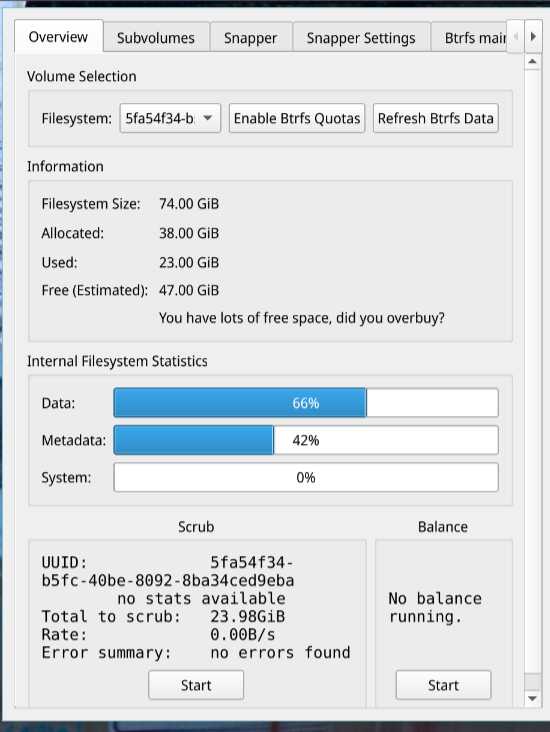

I have btrfs-assistant installed and running on MX-Linux.
Done: I will test now and report back.
:100: Verified: Works on systemd-free debian-based MX-Linux
I did want to pass along the fact that I had to install the packages libbtrfs-dev & libbtrfs0 & libbtrfsutil-dev to succesfully compile. Of course since you are now using libbtrfsutil. Took me a minute to deal with what packages I needed. :wink:

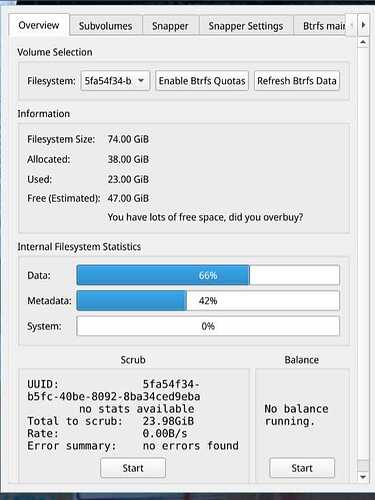

Compiled and tested on MX-Linux (systemd-free) complete.
:100: Verified:: @ / root restored several snapshots complete
:100: Verified:: @home restored several snapshots complete
Everything looks A-OK. :ok_hand:
