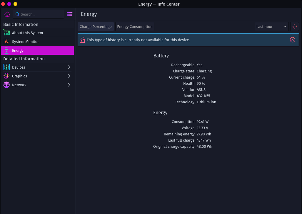

Here’s a screenshot of the info center.
It is showing charging even though my laptop is unplugged.
