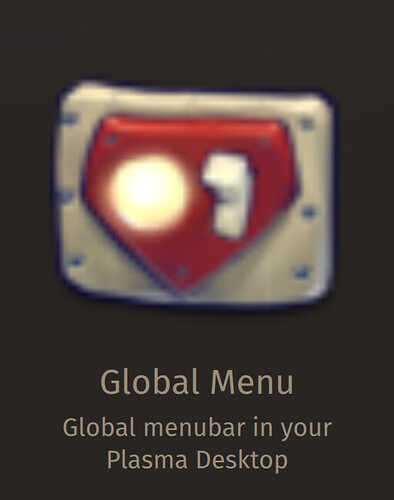

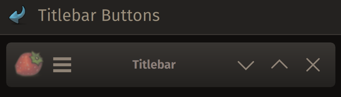

Both default panels are gone, replaced with a single new standard taskbar style one. In the window decoration settings, the menu button is on the titlebar. Normally, the menu button would show up, at this point.

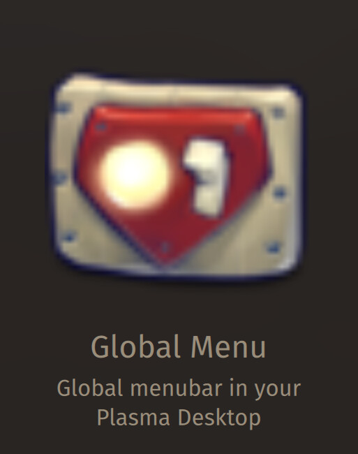

The global “appmenu” has no instances.
Yet, no programs with such a menu show it:

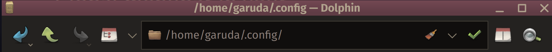

There’s nothing referencing any menu anything in kwinrc, and the ./config/(…)appletsrc has no phantom appmenu entry, that I can see.
