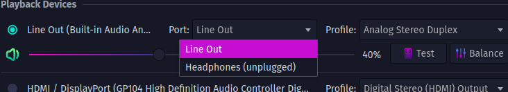

I will start with visible indicator of the issue, I don't have correct profile in audio settings dropdown
pavucontrol-qt looks the same

Also alsamixer was displaying correct 5.1 volume controls but only after i manually selected intel(...) card.
At the moment i have only stereo that uses front left and right speaker
The first(dont want to install unnecessary packages) question is can i make it work using only pipewire or do i need to use pulseaudio/alsa? Previously i think i totally removed pipewire to get it working but it does not seem to be the best possible solution. But I don't really know anything about pipewire
I think the solution is retarded - if someone can confirm that's really only this , not something else i did. Installed alsa-utilis for alsxamixer. In alsamixer switched to intel card, Changed "channels" slider to 6 and reboted
