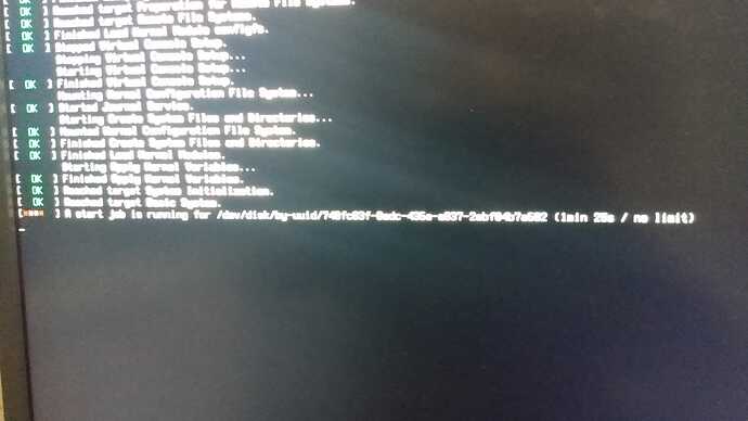

A start job is running for /dev/disk/by-uuid/.... hangs after upgrade

did a update using
sudo garuda-update
after rebooting it hangs at this point
Tried different kernels but got the same result.
Had to revert to a snapshot to get the system booted up.
Never update with sudo. I believe it actually says that in Terminal.
Just run garuda-update in term. Perhaps try the Zen 3 kernel if you are still having issues.
Were there any error messages during the update, and if so, which ones?
A start job is running for /dev/disk/by-uuid/… hangs after upgrade
Use last working snapshot.

You didn’t run blkid with sudo, or your system is in bad shape with no UUIDs
Ok never mind, it just scrolled way over there..I see them now.
Can you provide output of ‘swapon -s’ and ‘cat /proc/cmdline’?
FYI when it gets to that line in the picture it just hangs there, I stopped the boot after 15 mins and restored to a working snapshot, so I still have a bunch of updates to my system that I’m not going to do
It appears UUID 748fc83f-8edc-436a-a837-2ebf04b7a602 is your primary boot drive. Unfortunately, the nofail flag will be of no use for your boot drive in fstab. I was hoping that UUID 748fc83f-8edc-436a-a837-2ebf04b7a602 was an auxiliary data drive and that the nofail flag would help with your problem.
Sadly, that is not a viable fix in your case.
Filename                                Type            Size            Used            Priority
/dev/zram0                              partition       32767996        128920          100
File: /proc/cmdline
BOOT_IMAGE=/@/boot/vmlinuz-linux-vfio root=UUID=748fc83f-8edc-436a-a837-2ebf04b7a602 rw rootflags=subvol=@ rd.driver.pre=vfio-pci loglevel=3 iommu=1 amd_iommu=on ibt=off
Thanks…but sorry, I got nothing now too. (I’d had very similar behavior when a swap partition got remade with a new UUID, and I thought it was worth checking).
So no idea, why this happened, but I just did another
garuda-update
everything worked fine this time
